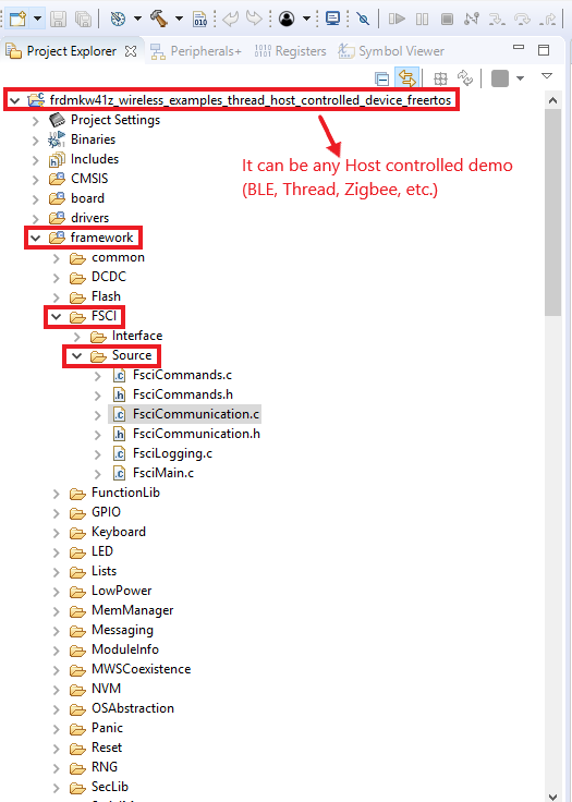

  1. Go to 'FsciCommunication.c' file.
  2. Search for 'fsci_packetStatus_t FSCI_checkPacket( clientPacket_t *pData, uint16_t bytes, uint8_t* pVIntf )' function.
  3. Comment all line codes related to checksum verifying. The image below shows what has to be commented.

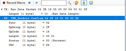

  5. Verify functionality with Test Tool. Select any command and check Raw Data checkbox. Delete the CRC data field and send the FSCI message pressing Send Raw. The loaded command set will vary depending on the demo you are using (Thread, ZigBee, BLE, etc.).
The FSCI message is sent without a CRC field and the board responses to the command successfully.
