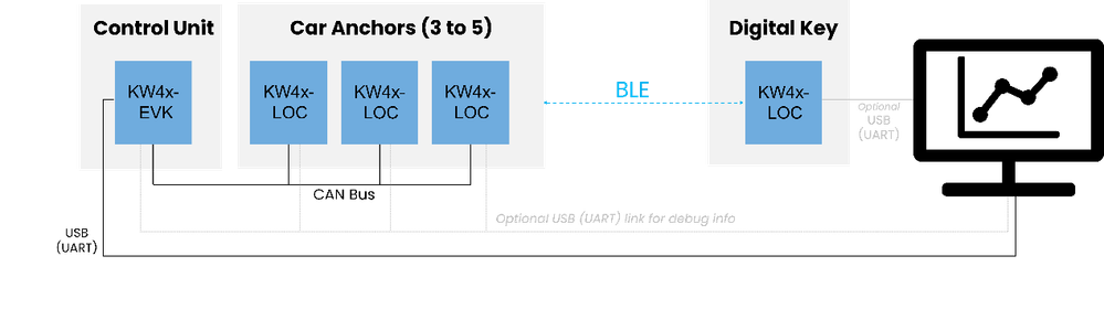

The system is composed of multiple KW4x boards, each with a specific role. On board is used as Digital Key, to be caried by the user, the other represent the Car sub-system. On this Car Sub-system, all boards are connected to each other using the CAN bus. The CAN bus fulfills the purpose to power all boards with 12V and to allow communication between the boards:
Control Unit (KW4x EVK-Board)
Car Anchors (KW4x LOC-Board)
Digital Key (KW4x LOC-Board)
Role:
Central decision-making node
Functionality:
- Coordinates BLE anchors.
- Triggers actions based on received data
Role:
BLE devices connected to the Control Unit via CAN bus
Functionality:
- Advertise BLE presence.
- Wait for a Digital Key to connect.
- Act as CS initiators during the session.
Role:
Acts as the remote BLE device
Functionality:
- Scans for BLE anchors.
- Initiates connection with a Car Anchor.
- Once connected, behaves as a CS reflector.

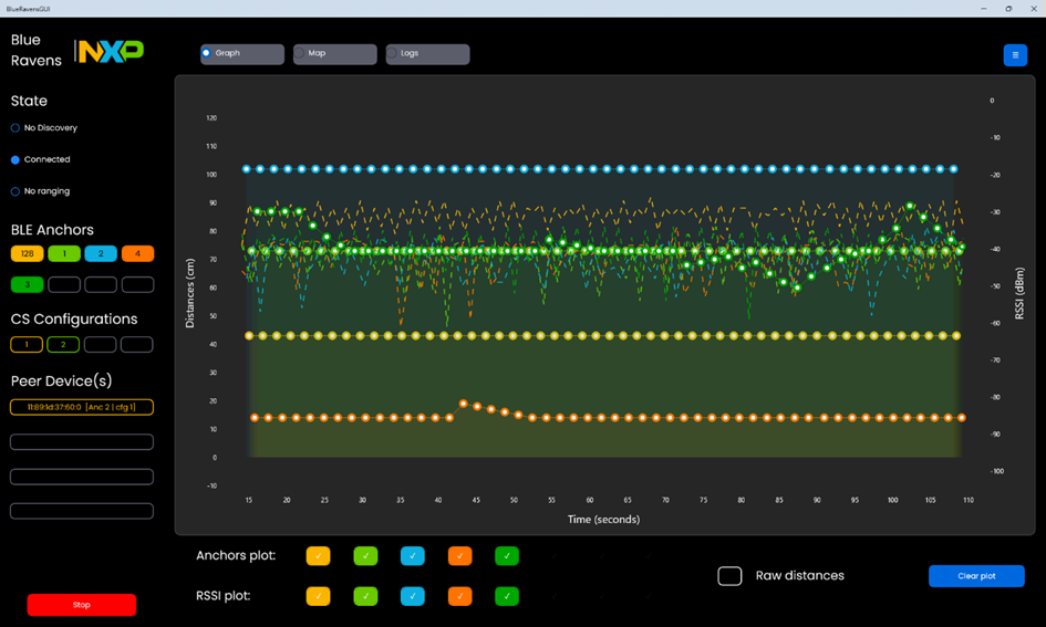

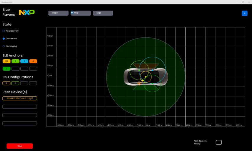

A Desktop application is used to monitor the states and monitor the measurement done by the system:
Using the successive measurement on each anchors, the Car sub-system is able to estimate the Digital Key position (Disclaimer: this solution is not consider accurate in dynamic environments)
