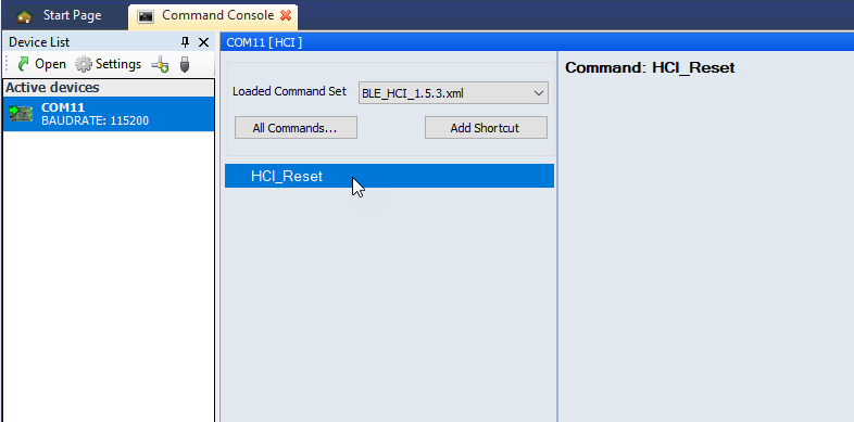

Running Demo
1. Load the board with hci_black_box example.
2. Open the Test Tool 12 software

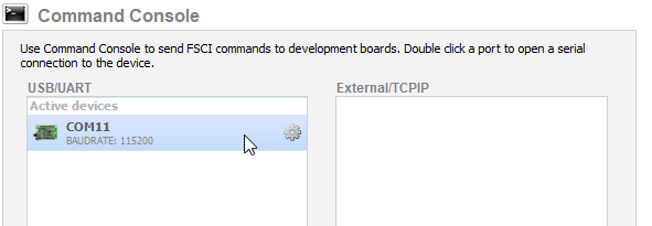

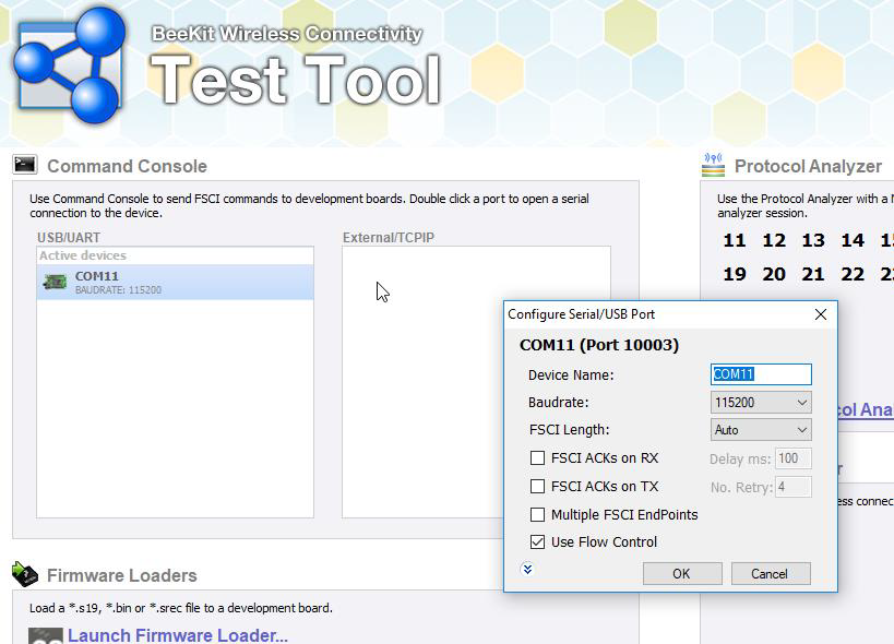

3. Set up the correct Serial Configuration. If there were no changes in the application the default
configuration will correspond to the one showed in the following figure.

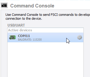

4. Double click on the active device that you want to test, this will open the COM port in the
command console.

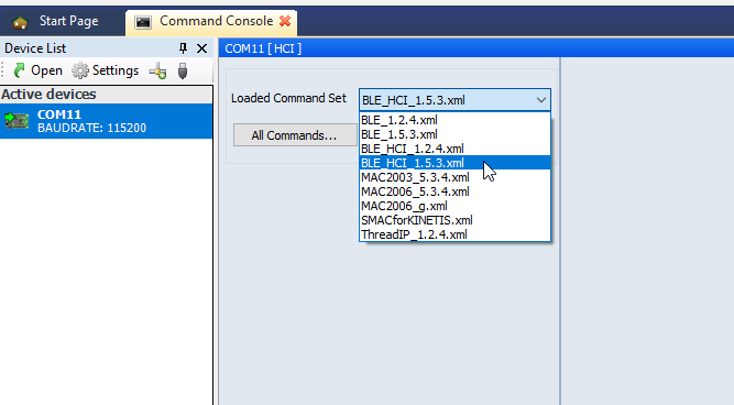

5. Set the command set to the BLE_HCI.xml. This file has a list of the HCI commands that the user
can send to the device, some of the commands have some options to be configured if necessary
or some data to be filled.

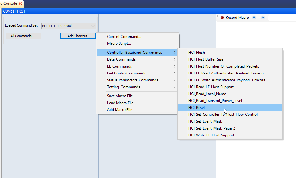

6. To make easier the use of frequent commands, there is the option to add a shortcut to the
command and the chosen behavior will be added to the panel.

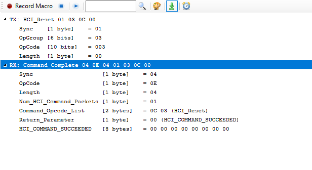

7. Once you add the shortcut or choose the command or your preference, just double click over it
and the tool will send the command to the device. In this case, we will send a reset on the board,
this command does not receive any extra parameters, data or need any extra configuration.
8. If successful there will be a response or acknowledge of the behavior that will be shown in the
right panel.

I'm using the MK22FN512VLL12 as the host MCU and the KW30Z as the bluetooth module on my device. They're connected by UART and I have the hci_app firmware loaded on the KW30Z. In the example above you send a 'Reset' command through the Test Tool software. If I'm sending a message directly over UART to the KW30Z could I send the same command byte for byte (01 03 0C 00)? Or do I need to add/omit data?
Thanks!
Josh
Hi Josh,
Yes, you are right, it is the same command.01 03 0C 00 You could find all of the HCI commands in the Bluetooth Specification.
Mario
