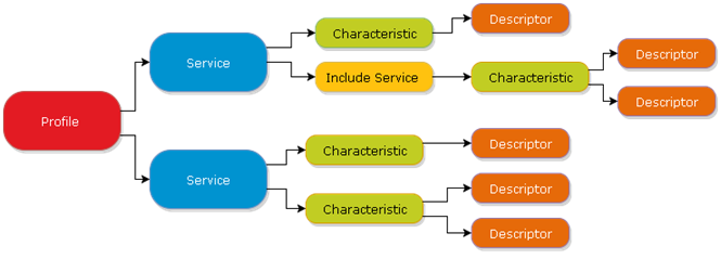

Bluetooth Low Energy allows exchange of information using the Generic Attribute Profile (GATT), GATT defines below two roles:
  1. Server: Device that stores the information.
  2. Client: Device that request for information from the server.
Going forward, this post describes how to implement a BLE Server using the FSCI black box application with Test Tool.
The server device can implement the GATT Database using below two methods.
  1. Static database: MACROs are used to add services, characteristics, etc.
  2. Dynamic database: APIs are used to add services, characteristics, etc. It is useful when runtime database update is required. This is the approach used by FSCI for the management of GATT databases.
The below figure shows an example of database hierarchy.
 Figure 4. GATT Database
Service: It is a set of information. i.e., sensor location, sensor read value, etc. Bluetooth SIG has defined universally unique identifier (UUID) for various services and characteristics. This UUID will be useful to add services and characteristics to the database. Heart Rate, Battery Information, Device Information are examples of the service.
Characteristic and value: It is the actual entity where information and its value are stored when the characteristic and value are added into the database. i.e., Device information service can have characteristics like manufacturer name, model string, Hardware version, etc.
Descriptor: It is used to provide additional information regarding the characteristic and its value, e.g. format, scale, unit, etc.
Client Characteristic Configuration Descriptor (CCCD): It is a descriptor used by the client device to enable or disable the notifications or indications.
When the specific component is added using GATT_DB APIs, the stack will assign a handle to that component to index it in the database.
