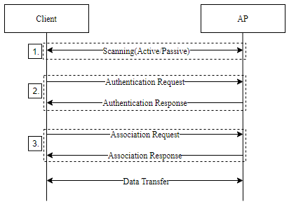

In 802.11 standards, the connection procedure includes three major steps that shall be performed to make the device part of the Wi-Fi network and communicate in the network. Those three steps are device discovery (scanning), device authentication (checking compatibility-capability etc. before connection) and then finally establishment of connection (Association). Going forward, this post provides details for each step. The message exchange in connection procedure is shown below.
Figure 1. Connection Process in open system

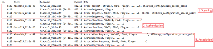

Figure 2. Messages exchange in Connection Process
Figure 2 shows Wi-Fi sniffer log for messages exchange procedure between Client and AP device at the time of connection, here Client device is Xiaomi and AP is Marvell device.

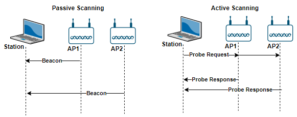

A passive scan generally takes more time, since the client must listen and wait for a beacon versus actively probing to find an AP. Another limitation with a passive scan is that if the client does not wait long enough on a channel, then the client may miss an AP beacon.
  • Active scan: Discovering the network by scanning all possible channels and listening to beacons is not considered to be very efficient. To enhance this discovery process, stations often use what is called active scanning.
In the active scanning mode, stations still go through each channel in turn, but instead of passively listening to the signals from AP, stations send a probe request management frame aimed at asking what network is available on this channel. If any AP or active station in an IBSS is presenting that frequency, they should answer with the probe response frame.
Figure 4. Scanning Methods

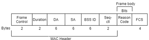

The disassociation frame (DA) can be the unicast MAC address of the station to disassociate or a broadcast address if the AP needs to disassociate all the stations in its network. In case of unicast frame, the frame will get acknowledge by receiving station and the broadcast frames are not acknowledged.
Figure 9. Disassociation Frame
The Disassociation frame is quite small. It contains only one field “Reason code”.

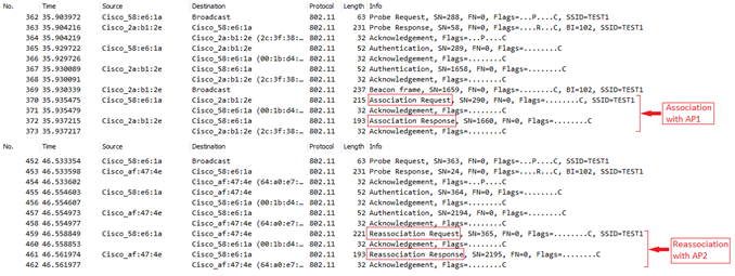

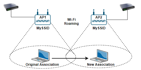

Roaming, in the context of an 802.11 wireless network, is the process of a client moving an established Wi-Fi network association from one access point to another access point within the same Extended Service Set (ESS) without losing connection (e.g. within a defined time interval, usually in the range of a few seconds). The roaming time should be smaller for the better performance.
In the roaming process, the mobile device will send the disassociation frame to the previously associated Access Point (AP), and will start re-association process by exchanging 802.11 frames with another access point to which the device wants to connect. The client device scans the another AP then exchange authentication frames after that it will send re-association request, here instead of association re-association request is used and the first 2 steps of connection process remains the same.
Figure 12. Message Exchange in Roaming Process
Figure 13. Roaming representation
