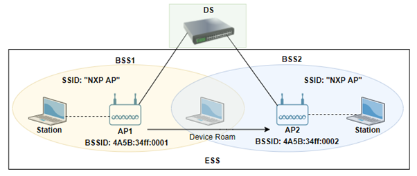

  • Basic Service Set (BSS): A group of stations that are successfully synchronized for 802.11 communications. BSS contains one AP and one or more client stations. In BSS, stations have layer 2 connection with AP and are known as associated.
  • Basic Service Set Identifier (BSSID): All basic service sets can be identified by a 48-bit (6-octet) MAC address known as the Basic Service Set Identifier (BSSID). The BSSID address is the layer 2 identifier of each individual basic service set. Most often the BSSID address is the MAC address of the access point.
  • Distribution System (DS): A system that interconnects a set of basic service sets and integrated Local Area Networks (LANs) to create an Extended Service Set (ESS). It is used to extend wireless network coverage.
  • Extended Service Set (ESS): In extended service set, one or more basic service sets are connected. An extended service set is a collection of multiple access points and their associated clients.
  • Independent Basic Service Set (IBSS): An IBSS consists only of client stations that do peer-to-peer communications. An IBSS is a self-contained network that does not have an access point.
  • SSID/ESSID: The logical network name of an Extended Service Set (ESS) is often called a Service Set Identifier (SSID). This name allows stations to connect to the desired network when multiple independent networks operate in the same physical area.
  • Roaming: It is a process of a client moving from one access point to another access point within the same Extended Service Set (ESS) without losing connection. It is described in detail in 802.11 connection disconnection process post: [802.11] Wi-Fi Connection/Disconnection process .
Below figure shows DS, AP, Station, BSS, SSID, BSSID and ESS.

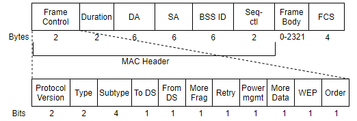

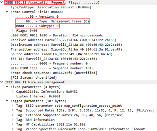

Management frames are used by wireless stations to join and leave the basic service set. 802.11 management frame is also called Management MAC Protocol Data Unit (MMPDU). It has a MAC header, a frame body, and a trailer. It doesn’t carry any upper layer information.
There is no MAC Service Data Unit (MSDU) encapsulated in the MMPDU frame body, it carries only layer 2 information fields and information elements, it does not carry higher layer (Layer 3 to 7 of OSI model) data. A management frame must have fixed length information fields and it may have information elements that are variable in length.
Management/MMPDU frame body content depends on the sub type field, based on the sub type field it has payload like Status/Reason code, device capability information etc. Few of the management frames i.e. Beacon, Authentication, Association are described in the Connection setup process post [802.11] Wi-Fi Connection/Disconnection process.
Below figure shows management frame structure.
Figure 2. Management Frame structure
Type field available in frame control field, that is set to 00 for the management frame. Management frames have 24-bytes long MAC header and header contains three addresses.
  • DA field is the destination address of the frame, it can be broadcast or unicast depending upon frame subtype.
  • SA field is MAC address of the station transmitting the frame.
  • BSSID is MAC address of AP.
  • Frame body is variable size. Size and content of the body depend on the management frame subtype.
Figure 3. Management Frame

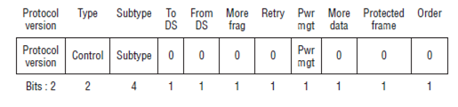

Control frames are associated with the delivery of data and management frames, it does not have a frame body. Control frames contain PHY, preamble, layer 2 header and trailer. Control frames can be transmitted at different data rates as they perform many different functions.
All control frames use the same Frame Control field that is shown in the figure below.
Figure 4. Control Frame structure

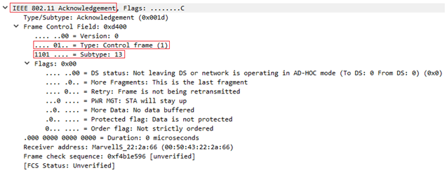

Figure 5. Control Frame
The type field value for the control frame is 01 and subtype fields identify the function of a frame. Table below shows the different types of control frames.

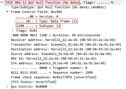

Data Frames

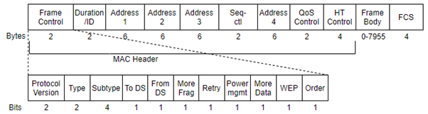

Data frames carry the higher level protocol data in the frame body. Data frames are categorized according to function. Total 15 sub types of data frames are defined in 802.11 standard. Type field value for the data frames is 10. One such distinction is between frame that carries data and frame that does not carry data (perform management function). Figure below shows data frame structure.
Figure 6. Data Frame structure
Figure 7. Data Frame
Each bit of the SubType field available in the frame control field has specific meaning as below.
  • Bit 4 (B4): Changing it from 0 to 1 indicates the data subtype includes +CF-Ack.
  • Bit 5 (B5): Changing it from 0 to 1 indicates the data sub type include +CF-Poll.
  • Bit 6 (B6): Changing it from 0 to 1 indicates that the frame contains no data, specifically, that it contains no Frame Body field.
  • Bit 7 (B7): Changing it from 0 to 1 indicates Quality of Service (QoS) data frame.
Data frames that appear only in the contention-free period can never be used in an IBSS. Below is the list of data frames.

Null 100 No It can be contention based and free both
CF-Ack 101 No Yes
CF-Poll 110 No Yes(AP only)
CF-Ack + CF-Poll 111 No Yes(AP only)
QoS Data 1000 Yes No
QoS Data + CF-Ack 1001 Yes Yes
QoS Data + CF-Poll 1010 Yes Yes(AP only)
QoS Data + CF-Ack + CF-Poll 1011 Yes Yes(AP only)
Qos Null 1100 No It can be contention based and free both
