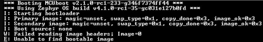

 After resetting the device, the output will be seen as image below. At this point there isn't any image in the primary or secondary slots, as expected MCUBoot will not find an application to jump to.

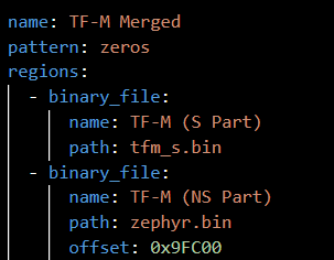

The Zephyr ecosystem does in fact create a tfm_merged.hex. Currently it is not compatible with the modifications made in this guide, so as a short-term solution the following steps will manually merge the two individual binaries that are also generated in the previous build step and are found in the build folder of the project.
tfm_s.bin - Secure image located in nxp_zephyr\zephyr\build\tfm\bin
zephyr.bin -Nonsecure image located in nxp_zephyr\zephyr\build\zephyr
 Note: This article does not show detailed steps of using the SPSDK command line tool. If detailed steps are needed please refer to spsdk.readthedocs.io. Additionally, the SPSDK is not necessary to merge the binaries, it can also be done manually by pasting the non-secure image at offset shown below in secure image binary.
  1. Use the following command to generate the template to merge the binaries.
    nxpimage utils binary-image get-template -o binary_merge_template.yaml
  2. Edit the template. Calculate the offset of the location of the non-secure image using FLASH_S_PARTITION_SIZE from the flash_layout.h header file. In this example the value is 0x9FC00.
  3. Use the following command to merge the binaries.
    nxpimage utils binary-image merge -c binary_merge_template.yaml -o merged_tfm_demo.bin
  4. Place the merged_tfm_demo binary in a known location to easily find and sign it in the following steps.

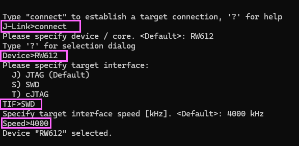

Using Jlink
Since the mcuboot image has already been flashed to the device. Lets flash the signed image using jlink directly.
Assuming that Jlink has been installed to your PC. You can find jlink.exe at:
C:\Program Files\SEGGER\JLink_V###\JLink.exe
To connect to the device.
> connect
> RW612
> SWD
> 4000

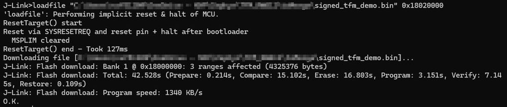

The primary slot is at 0x18020000
loadfile "\knownPath\signed_tfm_demo.bin" 0x18020000
