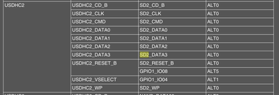

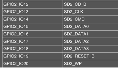

Hello all,
I have a custom board based on iMX8MP with U-Blox Maya-W266 wifi module integrated. (Schematic diagram snippets attached).
bgaurav1718_0-1729657870368.pngbgaurav1718_0-1729657870368.pngbgaurav1718_2-1729657982861.pngbgaurav1718_2-1729657982861.png
SD2_X pins from U-Blox are connected to GPIO2 port of iMX8MP as shown below:

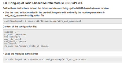

After booting the board, I followed instructions from "Getting Started with NXP-based Wireless Modules on i.MX 8M Quad EVK Running Linux OS" to bring up the wifi module:
However, I do not see any related messages in dmesg command output. I verified the configurations of wifi_mod_para.conf to be correct. Also, the firmware binary file is present inside nxp directory.
I have no idea on what to check for in further steps. I am not sure whether modifications in device tree are needed since the hardware designs are basically identical to the im8mp-evk design.
Any guidance would be of great help. Thank you!!

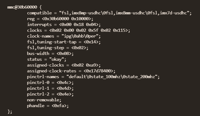

bgaurav1718

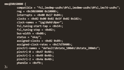

I installed a new image and looked through its device tree.
usdhc1 is mapped to mmc@30b40000,
usdhc2 is mapped to mmc@30b50000,
usdhc3 is mapped to mmc@30b60000.
bgaurav1718_1-1729754242320.pngbgaurav1718_1-1729754242320.pngbgaurav1718_2-1729754254245.pngbgaurav1718_2-1729754254245.png
I think this is what the device tree configuration is supposed to be. Still I get the same message
[ 2.107370] mmc2: new HS400 Enhanced strobe MMC card at address 0001

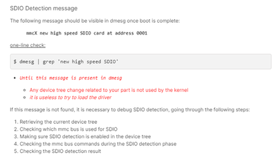

NOTE: I was reading an this article related to the issue. There, it mentions following:
Regarding the schematic, I have attached an image in original question. The pins from UBlox are connected to SD2_xxxx pins of the processor.  These pins belong to USDHC2.
13,463件の閲覧回数

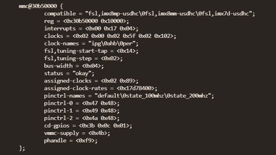

bgaurav1718
usdhc2 is at address 30b50000. It is aliased as mmc1. So, mmc1 is probably where the WiFi module is connected. But there is only one message in kernel log related to mmc1:
[ 3.312631] mmc1: SDHCI controller on 30b50000.mmc [30b50000.mmc] using ADMA

Please try add this node to your dts.
&usdhc2 {
assigned-clocks = <&clk IMX8MP_CLK_USDHC2>;
assigned-clock-rates = <400000000>;
pinctrl-names = "default", "state_100mhz", "state_200mhz";
pinctrl-0 = <&pinctrl_usdhc3>;
pinctrl-1 = <&pinctrl_usdhc3_100mhz>;
pinctrl-2 = <&pinctrl_usdhc3_200mhz>;
bus-width = <8>;
non-removable;
status = "okay";

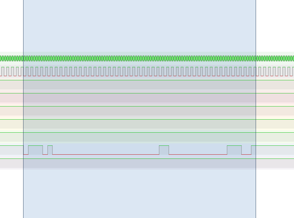

bgaurav1718
Hi @shaun_wu
I tested the signals in SDIO line. The clock seems fine. But the command is not correct. It needed to be 0 but it is something else. So, I guess the settings in device tree I am using is still wrong.

bgaurav1718
I have added the details. Since I am using dts file decompiled from dtb file, the symbols you mentioned are converted into corresponding hex values.
I tried to compile this dts into dtb by commenting out the lines that were not shown in your device tree. The compiler showed some errors, so I had to include those lines.
Hex values in pinctrl-X belong to following:
Even with this entry in device tree, the problem still exits.
Since there is only one parameter in the device tree you suggested, I tried removing the second parameter. I still get the same result.

shaun_wu
Hello @bgaurav1718
You could check shematic.
