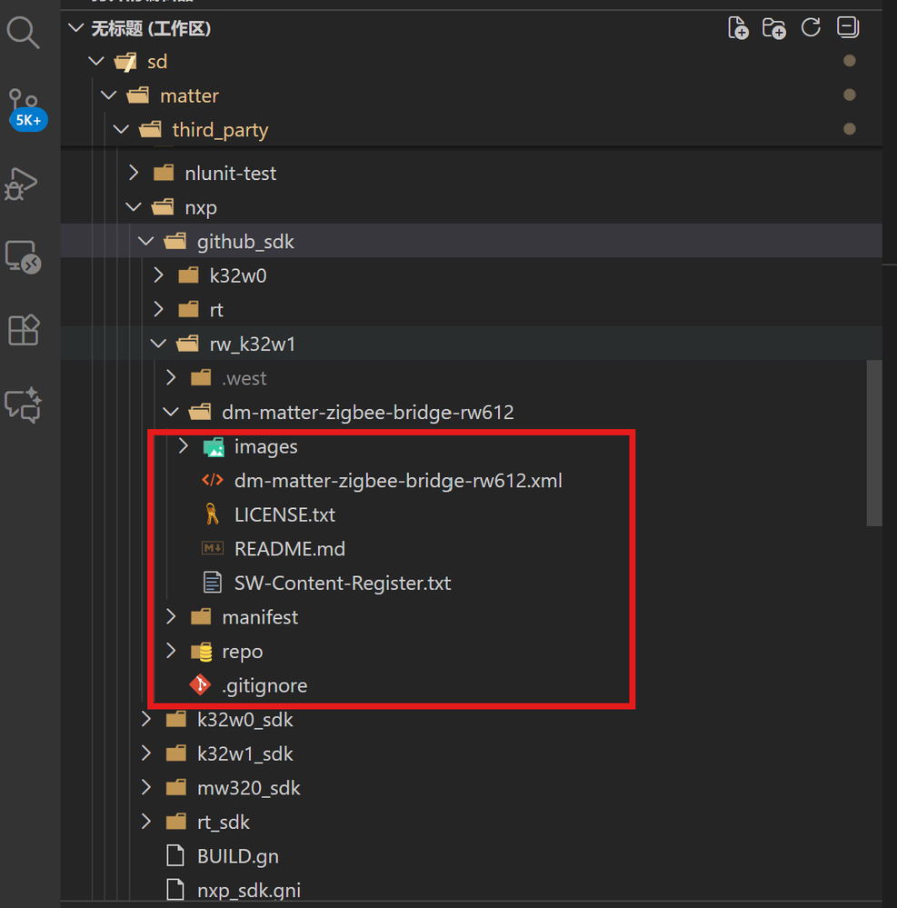

MrShen
Hello!
According to Build Matter OTBR and Zigbee Bridge application, execute git clone https://github.com/nxp-appcodehub/dm-matter-zigbee-bridge-rw612.git
The examples, src, and third_party folders were not found in the dm-mater-zigbee-bridge-rw612 file, dm-matter-zigbee-bridge-rw612/examples/bridge-app/nxp。
Many files are missing, which makes it impossible to execute and compile them later.屏幕截图 2025-11-14 192328.png屏幕截图 2025-11-14 192328.png

Christine_Li
Hi, @MrShen
Sorry for the inconvenience to you.
I received our internal team's feedback that due to recent change in ACH Matter Zigbee Bridge, we need to update UG10185.
Can you please have a try with below command and let me know whether it works for you?
git clone -b rw612_with_external_transceiver https://github.com/nxp-appcodehub/dm-matter-zigbee-bridge-rw612.git
I tried on my local side, I can download it.
By the way, for your convenience, we have have an update README in below link:
https://github.com/nxp-appcodehub/dm-matter-zigbee-bridge-rw612/blob/rw612_with_external_transceiver...
Please let me know whether have any other concerns on this case, other wise, please do not hesitate to mark my answer as a solution, so that we can close this case.

MrShen
Hello! The nxp file was not found in dm-matter-zigbee-bridge-rw612/examples/bridge-app/
