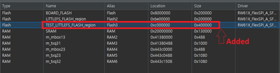

I encountered an error while attempting to add a 4MByte Flash region to the frdmrw612_wifi_cli_over_ble_wu project, as shown in the image below.
I tried to initialize the new Flash region by creating a separate lfs_config and using the existing lfs_init function, but an error occurred during the lfs_mount process.
The error occurs specifically in the lfs_mount function when calling the lfs_dir_fetchmatch function, which returns an error value of -5.
What additional aspects should be checked when adding a new Flash region?
For reference, the symbols.ldt and end_text.ldt files have been updated with the new Flash region information, based on the existing LITTLEFS_FLASH_region information.

Hi, @DanielRuvalcaba
The SDK version I am using is 2.16.100, as shown in the image below.
To reproduce the situation, I performed the following steps:
Step 1
In MCUXpresso, navigate to Project properties -> C/C++ Build -> MCU Settings and allocate the TEST_LITTLEFS_region.
Step 2
In the project folder, navigate to linkscripts and add the following content to two files:
   1. symbols.ldt
      TEST_LITTLEFS_FLASH_START_ADDRESS = __base_TEST_LITTLEFS_FLASH_region;
      TEST_LITTLEFS_FLASH_SECTOR_SIZE = 0x1000; /* 4k flash sector size */
      TEST_LITTLEFS_FLASH_MAX_SECTORS = (__top_TEST_LITTLEFS_FLASH_region
      TEST_LITTLEFS_FLASH_START_ADDRESS) / TEST_LITTLEFS_FLASH_SECTOR_SIZE;
    2. end_text.ldt
      .TEST_LITTLEFS_FLASH_region :
      . = ORIGIN(TEST_LITTLEFS_FLASH_region) + LENGTH(TEST_LITTLEFS_FLASH_region) - 1;
     } > TEST_LITTLEFS_FLASH_region
Step 3
Flash Config
  • Define the flash specifications and write the Test_LittleFS_config as shown in the attached test_littlefs.c file.

    Step 4
    TEST_LITTLEFS INIT
    • Call the lfs_t * test_lfs_init(void) function in the test_littlefs.c file to attempt initialization.
    • Call the lfs_mount function and observe that an error occurs in the return result.

Thanks for the instructions.
I am having 2 issues while replicating this:
1. The following "TEST_LITTLEFS_FLASH_MAX_SECTORS = (__top_TEST_LITTLEFS_FLASH_region TEST_LITTLEFS_FLASH_START_ADDRESS) / TEST_LITTLEFS_FLASH_SECTOR_SIZE;" in symbols.ldt is giving me some problems in the linker. Is it defined correctly?
2. The project can't find #include "ble_lower_level.h" and #include "audio.h". These files are not included in the original wifi_cli_over_ble_wu example, right?
Daniel.
3,813 Views
hclee
1.
There was a typo in the part I mentioned.
The original is as follows:
EDGEFAST_BT_LITTLEFS_STORAGE_START_ADDRESS = __base_LITTLEFS_FLASH_region;
EDGEFAST_BT_LITTLEFS_STORAGE_SECTOR_SIZE = 0x1000;  /* 4k flash sector size */
EDGEFAST_BT_LITTLEFS_STORAGE_MAX_SECTORS = (__top_LITTLEFS_FLASH_region - EDGEFAST_BT_LITTLEFS_STORAGE_START_ADDRESS) / EDGEFAST_BT_LITTLEFS_STORAGE_SECTOR_SIZE;
What I wrote is as follows:
TESET_LITTLEFS_FLASH_START_ADDRESS = __base_TESET_LITTLEFS_FLASH_region;
TESET_LITTLEFS_FLASH_SECTOR_SIZE = 0x1000;  /* 4k flash sector size */
TESET_LITTLEFS_FLASH_MAX_SECTORS = (__top_TESET_LITTLEFS_FLASH_region - TESET_LITTLEFS_FLASH_START_ADDRESS) / TESET_LITTLEFS_FLASH_SECTOR_SIZE;
I thought I added it correctly according to the original format, but could there be a problem with this method?
