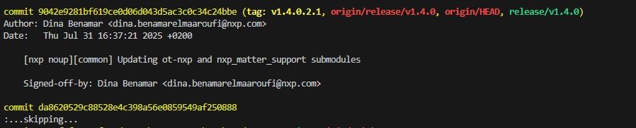

I am currently working with the Matter all-clusters-app example on the FRDM-RW612.
I debugged PacketBufferHandle::New(), I noticed that by default, the function allocated buffers with
pbuf_alloc(PBUF_RAM, allocSize, PBUF_POOL);
as by default CHIP_SYSTEM_CONFIG_USE_LWIP macro is set
This results in chained pbufs instead of a single contiguous buffer. For my case, I noticed a chain of total length 1962 bytes, split into one buffer with len = 1424 bytes and the next buffer with len = 426. In the New() function implementation, tot_len and len are forcibly set to zero, which override the values returned by pbuf_alloc(). Leading, to MaxDataLength() returning the length of first buffer 1424 bytes only.
My question is, what is the correct way to configure the macros so that PacketBufferHandle::New uses PBUF_RAM instead of PBUF_POOL, ensuring all relevant functions return the correct length. I want to have heap-allocated contiguous buffers instead of chained pool buffers, I guess the default pool allocation is limited because of MTU size 1500 bytes.
Here is the code for calling PacketBufferHandle::New

RomanVR
Hello @farazahmed8, hope you are doing well.
Could you please confirm if you are using the latest matter release (v1.4.0.2.1) and if the application works properly with the default configurations that you mention in your first post? (CHIP_SYSTEM_CONFIG_USE_LWIP macro set and allocated chained pbufs)
Additionally, please try by setting the value of the macro "LWIP_NETIF_TX_SINGLE_PBUF" to 1, you can found this at the path "<path-to-matter>/examples/all-clusters-app/nxp/rt/rw61x/third_party/connectedhomeip/src/lwip/standalone" and inside the file "lwipopts.h". This macro will try to make lwip to put all data into one single pbuf.
Please let me know if this works.
Best Regards!
