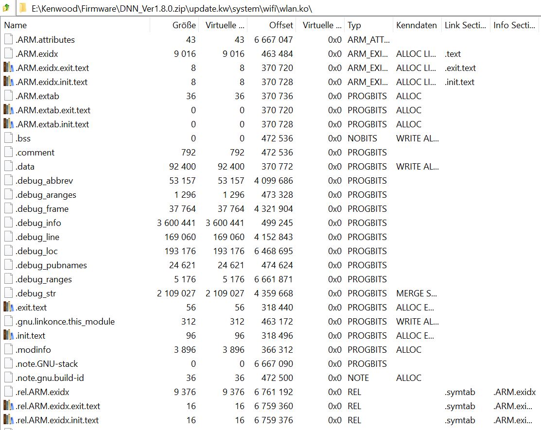

Hello everyone,
I bought a used Android car radio. Kenwood DNN9230.
Unfortunately the previous owner no longer has the WiFi USB adapter.
Kenwood wrote to me that the adapter is no longer available.
But it should be an adapter with RTL 8188CU. I bought one of these.
Unfortunately it is not recognized on the car radio.
Kenwood support believes that the original adapter has a fixed MAC address. I downloaded the latest update as a zip file for the car radio.
There I can see the entire folder structure and files.
Every time I start, a menu pops up asking me whether I want to log in as an administrator or as a guest.
As an administrator you can only work with an existing WiFi connection.
Even if I had a Wifi connection the request wouldn't work because according to Kenwood the "route-collector" service no longer exists.
My wish is that this query doesn't even appear. Unfortunately you cannot switch this off in the system. My idea now is to adapt the necessary files and then install the update. Would that be possible and if so, what information do you need?
Sorry for my bad english. I used the google-translator and hope it ist good enough. Hope for your help. best regards Wolfgang

Wolle64
Thanks cdoumenc,
No, sorry. Look below there is a screenshot from the content of the updatefile. So, i hope that i could edit some of the files to make run another Wifi-USB. I read about this that the wpa_supplicant, netd, file is needed. But when the original adapter use a fix Mac-adress, i think then a diffrent WIFI-Adapter don`t work, when it use another Mac-adress. Maybe it is possible to change the Mac-adress in the updatefile or to find out in which file are the mac-adress from the Wifi-Adapter. I don`t know.

cdoumenc
Check in directories "vendor", "wifi" and in PndrBrandingImg.png to get some brand names and know which company you can ask support to.

Wolle64
Thanks for help,
This files are in Wifi and Vendor. In Wifi is a file Wlan.ko. When i open this file there are many files in it. See below. The PndrBrandingImg.png shows only KENWOOD

cdoumenc
"I downloaded the latest update as a zip file for the car radio. "
Could you provide the URL where you got this zip if it is public, please ? Or via private message if it isn't.
So that I can check the wifi chipset reference.
In Vendor-lib-kw.JPG, I see "tcc88xx" for which internet searching shows it is a Telechips - Wikipedia
Application Processor based on ARM Cortex-A8 core.

Wolle64
Hi cdoumenc,
you are great,
here are the link from Kenwood for the latest Update 1.8
https://www.kenwood.com/cs/ce/mm/firmware/2013/2013c/software/DNN_Ver1.8.0.zip

cdoumenc
In this zip file, I see 2 binaries :
PS C:\Users\...\DNN_Ver1.8.0> dir
Directory: C:\Users\...\DNN_Ver1.8.0
Mode LastWriteTime Length Name
-a---l 08/03/2019 14:34 156 programinfo.bin
-a---- 08/03/2019 13:45 506296726 update.kw
with an hex editor (http://www.wxhexeditor.org), I don't see anything in programinfo.bin, but, in update.kw, I see, in ASCII/text that wifi linux module name is : system/wifi/wlan.ko
So, I think it is not a NXP wifi chipset since our driver module names are mlan.ko or moal.ko.
So, I suggest that you ask Telechips for support : Telechips

Wolle64
thank you very much.
i could open wlan.ko with 7zip. The content of these files are in my pictures wlan.ko and wlan-2.ko in my post bevor.
i found file .rodata.str1.4 and in there are this: (sorry for many text now)

########### rtw_suspend done #################
########### rtw_suspend fail !! #################
+rtw_dev_remove
+r871xu_dev_remove, hw_init_completed=%d
usb attached..., try to reset usb device
-r871xu_dev_remove, done
====> autoresume_enter
can't get autopm: %d
...pm_usage_cnt(%d).....
<==== autoresume_enter
rtw driver version=%s
v3.4.2_3727.20120404 Build at: %s %s
May 17 2012 11:44:39 wlan ==>autosuspend_enter...........
########### rtw_resume #################
bkeepfwalive(%x)
enc_algorithm(%x),wepkeymask(%x)
pid[1]:%d
########### rtw_resume done#################
%s, Open net dev failed
########### rtw_resume done with error#################
==> rtw_hw_resume
==> rtw_hw_suspend
%s, failed
CHIP TYPE: RTL8188C_8192C
Detect NULL_CHIP_TYPE
padapter->pwrctrlpriv.bSupportRemoteWakeup~~~~~~
padapter->pwrctrlpriv.bSupportRemoteWakeup~~~[%d]~~~
%s...pm_usage_cnt(%d).....
MAC Address from pnetdev->dev_addr= %02x:%02x:%02x:%02x:%02x:%02x
ui_pid[1]:%d
bDriverStopped:%d, bSurpriseRemoved:%d, bup:%d, hw_init_completed:%d
alloc usb_vendor_req_buf failed... /n
usb_endpoint_descriptor(%d):
bLength=%x
bDescriptorType=%x
bEndpointAddress=%x
wMaxPacketSize=%x
bInterval=%x
RT_usb_endpoint_is_bulk_in = %x
RT_usb_endpoint_is_int_in = %x, Interval = %x
RT_usb_endpoint_is_bulk_out = %x
nr_endpoint=%d, in_num=%d, out_num=%d
USB_SPEED_HIGH
NON USB_SPEED_HIGH
rtl8192cu %s set pid[%d]=%d
%s selector %d error
wpa_set_auth_algs, AUTH_ALG_SHARED_KEY and AUTH_ALG_OPEN_SYSTEM [value:0x%x]
wpa_set_auth_algs, AUTH_ALG_SHARED_KEY [value:0x%x]
wpa_set_auth_algs, AUTH_ALG_OPEN_SYSTEM
wpa_set_auth_algs, AUTH_ALG_LEAP
wpa_set_auth_algs, error!
======= RF REG =======
RF_Path(%x)
0x%02x 0x%08x
0x%05x %s: in=%s
, realmap strcmp OK = %s
rtw_efuse_map_read
OFFSET VALUE(hex)
%s
rtw_efuse_map_read : Fail
0x%02x %s 0x%02x %02X %s %02X %s %s
rmap addr = %x
cnts = %d
(addr + cnts parameter error
rtw_efuse_access error
rtw_efuse_access ok
0x%02x %s 0x%02X %s extra = %s realraw rtw_efuse_access raw ok
%02x %s %02x
%s
mac vidpid ableraw %s : [ available raw size] = %d %s : Command not found
[%s] wps_start = %d
wmap target data = %s
parameter error
rtw_efuse_map_write error
rtw_efuse_map_write ok
wraw cnts = %d
error data for mac addr = %s
Command not found
%s new_ifname:%s
disable%d %s disable
[%s] data = %s
N=%s
N=0000 [%s] extra = %s
wpsCM=
M=%.4d
M=0000 devN= status [%s] Role = %d, Status = %d, peer addr = %.2X:%.2X:%.2X:%.2X:%.2X:%.2X
Status=%.2d
role
Role=%.2d
peer_ifa
MAC %.2X:%.2X:%.2X:%.2X:%.2X:%.2X req_cm
CM=%s
peer_deva
%.2X%.2X%.2X%.2X%.2X%.2X group_id
%.2X:%.2X:%.2X:%.2X:%.2X:%.2X-%s [rtw_wx_set_pmkid] IW_PMKSA_ADD!
[rtw_wx_set_pmkid] BSSID exists in the PMKList.
[rtw_wx_set_pmkid] IW_PMKSA_REMOVE!
[rtw_wx_set_pmkid] IW_PMKSA_FLUSH!
[rtw_wx_set_pmkid] Use the new entry index = %d for this PMKID.
<WIFI@REALTEK> enable= setDN= [%s] %s %d
profilefound= [%s] In value = %s, len = %d
prov_disc= [%s] WiFi Direct is disable!
display keypad pbc label [%s] Unknown WPS config methodn [%s] NOT Found in the Scanning Queue!
nego= [%s] Start PreTx Procedure!
[%s] Not Found in Scanning Queue~
intent= [%s] intent = %d
ssid= [%s] ssid = %s, len = %d
got_wpsinfo= listen_ch= [%s] listen_ch = %d
op_ch= [%s] op_ch = %d
+rtw_wowlan_ctrl: Device didn't support the remote wakeup!!
rtw_wowlan_ctrl: subcode [%d], len[%d], buffer_len[%d]
0x%08x
======= BB REG =======
======= MAC REG =======
871x_driver is only for normal mode, can't enter mp mode
==> trigger gpio 0
==> set dm_bt_coexist:%x
==> delete ba:%x
rtw_read8(0x%x)=0x%02x
rtw_read16(0x%x)=0x%04x
rtw_read32(0x%x)=0x%08x
rtw_write8(0x%x)=0x%02x
rtw_write16(0x%x)=0x%04x
rtw_write32(0x%x)=0x%08x
read_bbreg(0x%x)=0x%x
write_bbreg(0x%x)=0x%x
read RF_reg path(0x%02x),offset(0x%x),value(0x%08x)
write RF_reg path(0x%02x),offset(0x%x),value(0x%08x)
continuous IOL_CMD_WB_REG to 0x%x %u times Success, start:%u, final:%u
continuous IOL_CMD_WB_REG to 0x%x %u times Fail, start:%u, final:%u
continuous IOL_CMD_WW_REG to 0x%x %u times Success, start:%u, final:%u
continuous IOL_CMD_WW_REG to 0x%x %u times Fail, start:%u, final:%u
continuous IOL_CMD_WD_REG to 0x%x %u times Success, start:%u, final:%u
continuous IOL_CMD_WD_REG to 0x%x %u times Fail, start:%u, final:%u
fwstate=0x%x
auth_alg=0x%x, enc_alg=0x%x, auth_type=0x%x, enc_type=0x%x
pmlmeinfo->state=0x%x
qos_option=%d
ht_option=%d
cur_ch=%d
cur_bw=%d
cur_ch_off=%d
sta's macaddr:%02x:%02x:%02x:%02x:%02x:%02x
rtsen=%d, cts2slef=%d
qos_en=%d, ht_en=%d, init_rate=%d
state=0x%x, aid=%d, macid=%d, raid=%d
bwmode=%d, ch_offset=%d, sgi=%d
ampdu_enable = %d
agg_enable_bitmap=%x, candidate_tid_bitmap=%x
tid=%d, indicate_seq=%d
can't get sta's macaddr, cur_network's macaddr:%02x:%02x:%02x:%02x:%02x:%02x
(B)DMFlag=0x%x, arg=0x%x
(A)DMFlag=0x%x
bSurpriseRemoved=%d, bDriverStopped=%d
free_xmitbuf_cnt=%d, free_xmitframe_cnt=%d
rx_urb_pending_cn=%d
sta_dz_bitmap=0x%x, tim_bitmap=0x%x
capability=0x%x
flags=0x%x
wpa_psk=0x%x
wpa2_group_cipher=0x%x
wpa2_pairwise_cipher=0x%x
qos_info=0x%x
dot118021XPrivacy=0x%x
dump rx packet (%d)
###### silent reset test.......#####
==>silent resete cnts:%d
v3.4.2_3727.20120404 off on turn %s Rx RSSI display function
=== DMFlag(0x%02x) ===
extra_arg = 0 - disable all dynamic func
extra_arg = 1 - disable DIG- BIT(0)
extra_arg = 2 - disable High power - BIT(1)
extra_arg = 3 - disable tx power tracking - BIT(2)
extra_arg = 4 - disable BT coexistence - BIT(3)
extra_arg = 5 - disable antenna diversity - BIT(4)
extra_arg = 6 - enable all dynamic func
wr(0xc50)=0x%x
wr(0xc58)=0x%x
rd(0xc50)=0x%x
rd(0xc58)=0x%x
dbg(0x210)=0x%x
dbg(0x608)=0x%x
dbg(0x280)=0x%x
dbg(0x284)=0x%x
dbg(0x288)=0x%x
dbg(0x664)=0x%x
dbg(0x430)=0x%x
dbg(0x438)=0x%x
dbg(0x440)=0x%x
dbg(0x458)=0x%x
dbg(0x484)=0x%x
dbg(0x488)=0x%x
dbg(0x444)=0x%x
dbg(0x448)=0x%x
dbg(0x44c)=0x%x
dbg(0x450)=0x%x
error dbg cmd!
======== Set channel_plan = 0x%02X ========
+rtw_get_aplist_info
Invalid BSSID '%s'.
BSSID:%02x:%02x:%02x:%02x:%02x:%02x
+rtw_wx_set_enc, flags=0x%x
EncryptionDisabled
rtw_wx_set_enc, key=%d
rtw_wx_set_enc():IW_ENCODE_OPEN
rtw_wx_set_enc():IW_ENCODE_RESTRICTED
rtw_wx_set_enc():erq->flags=0x%x
(keyindex_provided == 1), keyid=%d, key_len=%d
WEP wpa_set_encryption, crypt.alg = WEP
(1)wep_key_idx=%d
wep, set_tx=1
wep, set_tx=0
none TKIP
~~~~stastakey:unicastkey
~~~~stastakey:groupkey
CCMP %s...call rtw_indicate_disconnect
wpa_ie(length:%d):
0x%.2x 0x%.2x 0x%.2x 0x%.2x 0x%.2x 0x%.2x 0x%.2x 0x%.2x
SET WPS_IE
SET WPS_IE, wps_phase==_TRUE
IEEE 802.11bn IEEE 802.11b IEEE 802.11bgn IEEE 802.11bg IEEE 802.11an IEEE 802.11a IEEE 802.11gn IEEE 802.11g unassociated Rates (Mb/s): .5 %d%s wx_get_scan, mcs_rate_bitmap=0x%x
wpa_ie= %02x rsn_ie= %s strlen(msg):%u > IW_CUSTOM_MAX:%u
%s %s
Unknown WPA supplicant request: %d
rtw_add_sta(aid=%d)=%02x:%02x:%02x:%02x:%02x:%02x
rtw_del_sta=%02x:%02x:%02x:%02x:%02x:%02x
rtw_del_sta(), sta has already been removed or never been added
%s, len=%d
rtw_set_encryption(), sta has already been removed or never been added
clear default encryption keys, keyid=%d
r871x_set_encryption, crypt.alg = WEP
r871x_set_encryption, wep_key_idx=%d, len=%d
r871x_set_encryption: pwep allocate fail !!!
%s, set group_key, WEP
%s, set group_key, TKIP
%s, set group_key, CCMP
%s, set group_key, none
%s, set pairwise key, WEP
%s, set pairwise key, TKIP
%s, set pairwise key, CCMP
%s, set pairwise key, none
rtw_get_sta_wpaie, sta_addr: %02x:%02x:%02x:%02x:%02x:%02x
sta's wpa_ie is NONE
%s()-%d: rtw_malloc() ERROR!
Unknown hostapd request: %d
hw still in rf_off state ...........
%s call autoresume_enter....
======> autoresume fail.............
%s call ips_leave....
======> ips_leave fail.............
lps= ips= %u IPS_LEVEL_2 IPS_NORMAL =>%s
ssid=%s, len=%d
<=%s, ret %d
bDriverStopped=%d
IW_SCAN_THIS_ESSID, ssid=%s, len=%d
rtw_wx_set_scan, req->scan_type == IW_SCAN_TYPE_PASSIVE
START STOP %s rssi %d OK LINKSPEED %d MACADDR = %02x:%02x:%02x:%02x:%02x:%02x %*s %s US EU JP CN %s unknown country_code:%s, set to RT_CHANNEL_DOMAIN_FCC
%s rtw_wx_set_channel_plan error
set_mode = IW_MODE_AUTO
set_mode = IW_MODE_ADHOC
set_mode = IW_MODE_MASTER
set_mode = IW_MODE_INFRA
%s()-%d: rtw_xmit() return error!
%s-%d: skb_copy() failed!
pxmitbuf->pxmit_urb[i]==NULL +rtw_indicate_sta_disassoc_event
+rtw_indicate_sta_assoc_event
ASSOCINFO(ReqIEs= %02x ) include/net/cfg80211.h %s
%s, ucast=%d, cipher=0x%x
Unsupported cipher: 0x%x
%s, error rf_type=%d
%s:rf_type=%d
include/net/cfg80211.h remove monitor interface
Couldn't allocate wireless device
Couldn't allocate wiphy device
Couldn't register wiphy device
%s
=>%s
privacy=%d, key=%p, key_len=%d, key_idx=%d
%s wdev_priv.block is set
ssid=%s, len=%d
bssid=%02x:%02x:%02x:%02x:%02x:%02x
%s, fw_state=0x%x, goto exit
matched by bssid
matched by ssid
connect, matched == _FALSE, goto exit
%s, wpa_version=%d
%s, nl80211_auth_type=%d
%s(): Shared/Auto WEP
wpa_set_encryption: pwep allocate fail !!!
%s, key_mgt=0x%x
Invalid key mgt: 0x%x
%s, ie_len=%d
set wpa_ie(length:%d):
got wpa_ie
got wpa2_ie
SET WPS_IE
set ssid:dot11AuthAlgrthm=%d, dot11PrivacyAlgrthm=%d, dot118021XGrpPrivacy=%d
<=%s, ret %d
%s, mac==%p
%s, mismatch bssid=%02x:%02x:%02x:%02x:%02x:%02x
%s, sta_info is null
+%s
%s, fw_state != FW_LINKED|WIFI_AP_STATE
flush all sta, and cam_entry
free sta macaddr =%02x:%02x:%02x:%02x:%02x:%02x
%s, sta's dot8021xalg = 1 and key_installed = _FALSE
free psta=%p, aid=%d
-%s
%s, beacon_head_len=%d, beacon_tail_len=%d
add bcn, wps_ielen=%d
got p2p_ie, len=%d
Enable P2P function for the first time
enter GO Mode, p2p_ielen=%d
%s, Adding key for %pM
cipher=0x%x
key_len=0x%x
seq_len=0x%x
key_index=%d
pairwise=%d
WEP none TKIP CCMP wpa_set_encryption, crypt.alg = WEP
(1)wep_key_idx=%d
wep, set_tx=1
wep, set_tx=0
%s, : Obtain Sta_info fail
%s, : param->u.crypt.set_tx ==1
%s, ret=%d
error! fw_state=0x%x, iftype=%d
%s call netdev_open
%s, old_iftype=%d, new_iftype=%d
%s, role=%d, p2p_state=%d, pre_p2p_state=%d
%s, ifname=%s, type=%d
%s, monitor interface(%s) has existed
%s, ndev=%p, pmon_ndev=%p, ret=%d
Unsupported interface type
ndev=%p
radiotap len (should be 14): %d
should be eapol packet
frame_ctl=0x%x
%s, ielen=%d
Got P2P Capability Attr, grp_cap=0x%x, is_GO
[%s] In
rtw_cfg80211_inform_bss error
DIRECT- %s, bBusyTraffic == _TRUE
%s, fwstate=0x%x
%s without scan req
%s, scan abort when device remove
%s, unregister monitor interface
%s : fw_state=_FW_UNDER_SURVEY!
waiting for scan_abort time out!
%s, len=%d, ch=%d, ch_type=%d
channel_type_valid=%d
%s, fc == IEEE80211_STYPE_PROBE_RESP
%s, frame_control == 0x%x
%s, ack=%d
%s channel %02u duration %d
%s remain_ch:%u not in channel plan!!!!
pwdev->sme_state=%d
%s call cfg80211_roamed
Macaddr = %02x:%02x:%02x:%02x:%02x:%02x %s rssi %d include/net/cfg80211.h LinkSpeed %d %s: failed to allocate memory
%s: Android private cmd "%s" on %s
Unknown PRIVATE command %s - ignored
OK %s: bytes_written = %d
%s: failed to copy data to user buffer
START STOP SCAN-ACTIVE SCAN-PASSIVE RSSI LINKSPEED RXFILTER-START RXFILTER-STOP RXFILTER-ADD RXFILTER-REMOVE BTCOEXSCAN-START BTCOEXSCAN-STOP BTCOEXMODE SETSUSPENDOPT P2P_DEV_ADDR SETFWPATH SETBAND GETBAND COUNTRY P2P_SET_NOA P2P_GET_NOA P2P_SET_PS SET_AP_WPS_P2P_IE MACADDR BLOCK
There are named the Wifi-typ RTL8188c
I try to connect Telechips-Support and hope, they could help me
best regards
Wolle64
