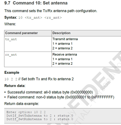

3. 受信アンテナ番号のセットコマンドについて、例が異なっている部分があります。
 ミスでしょうか? 10 0 2 2 // Set both TX and RX to antenna 2(P.27) → 10 2 2

10 0 2 2 // Set both TX and RX to antenna 2(P.27) → 10 2 2 (UM11717 P.51-59, 61, 64-66)
"10 2 2" is not working

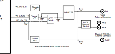

You need hardware antenna configure as dule mode first. Then FEM calibration file should change to dule antenna configure file.

Is "10 0 2 2" the correct single mode setting?
--> 10 1 1   // set tx/rx antenna to antenna 1
IW612 support dule antenna configuration.
