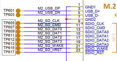

For the below question, I just found that there is not  "imx8mq-evk-usdhc2-m2.dtb" inside LF_v6.6.3-1.0.0_images_IMX8MMEVK.zip, even if it is the latest release. Could you please tell me Which release includes "imx8mq-evk-usdhc2-m2.dtb", or Could you send me that .dtb file?
2,226 Views
shaun_wu
Hello @jun_1
imx8mq-evk-usdhc2-m2.dtb this dtb file is for i.MX8MQ, not for i.MX8Mmini.
For i.MX8mm evk, M.2-SD is not supported in hardware. We only leave test point, you need to connect test point to SD2 which is micro sd slot then change dts to configure SD2 to m.2 SD.
The M.2 is default for pice card.
Best Regards
Shaun
