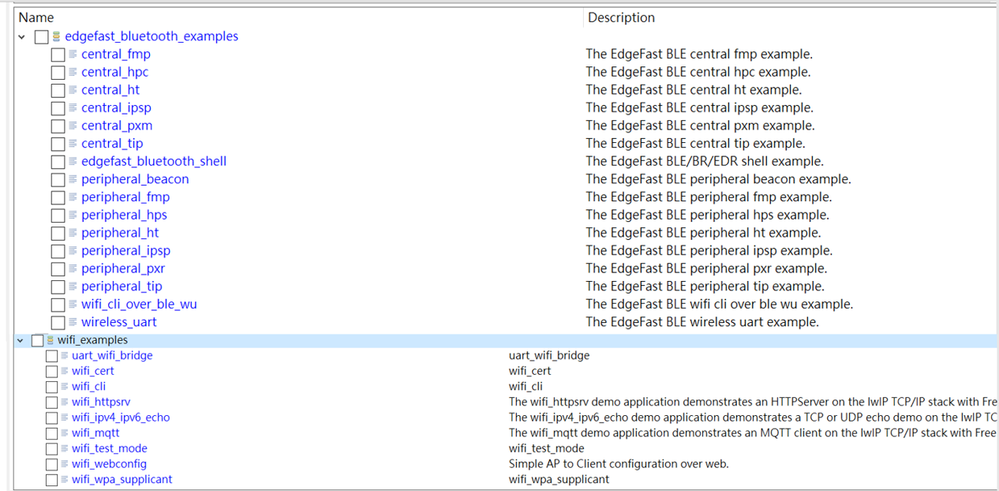

We want to develop WiFi(MQTT & HTTPClient) + BLE(peripheral +central) application but we don't have any idea to start developing new application, the following screenshot is the WiFi & BLE example in SDK.
We have some options as below:
1. Starting from WiFi example and porting the BLE example into WiFi example
2. Starting from the BLE example and port the WiFi example to the BLE example
3. Starting from the new project and port the WiFi and BLE example into an empty project.
Do you have any suggestions or guidance for us? or do you have any guideline for porting wifi & ble function/stack to an empty project?

Unfortunately, we don't have any guide on how to import the Wi-Fi and BT stack into an empty project. Nevertheless, I will pass your comments to the corresponding team.
On the other hand, I understand you need a BT + Wi-Fi project. I would recommend you take a look to the wifi_cli_over_ble_wu and base your application using this example.
I hope this helps!
