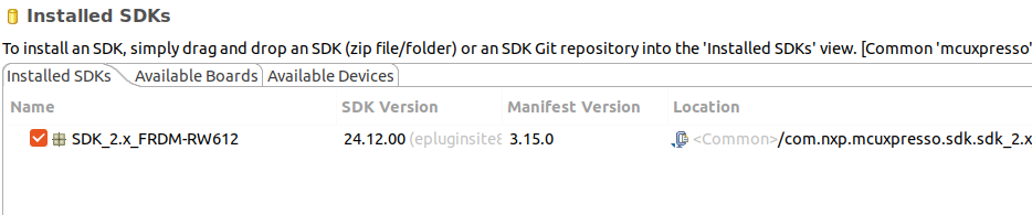

Installed SDK:
Screenshot from 2025-02-03 14-02-34.pngScreenshot from 2025-02-03 14-02-34.png

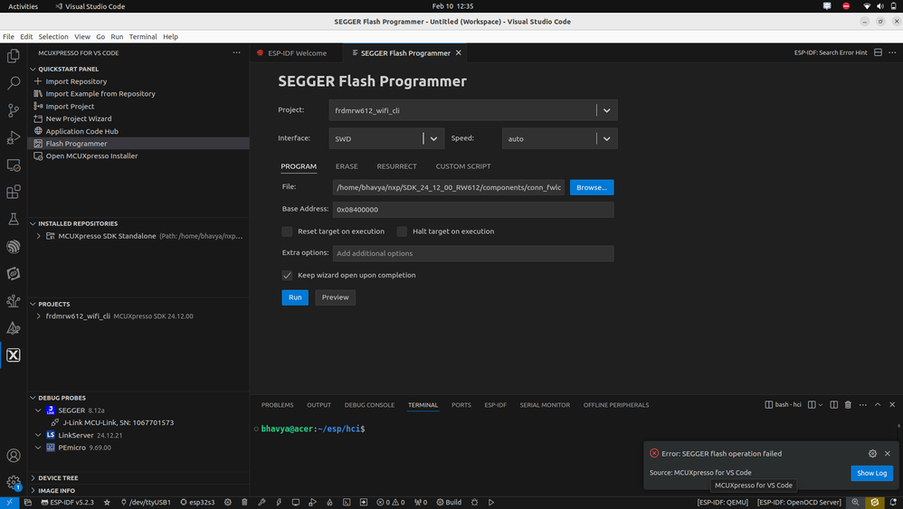

bmathukiya
Hi @sofiaurueta,
I have tried to follow the steps to flash the WiFi CLI app using VS code. But getting the same error.
I am attaching the screenshot for your reference.
Screenshot from 2025-02-10 12-35-20.pngScreenshot from 2025-02-10 12-35-20.png
