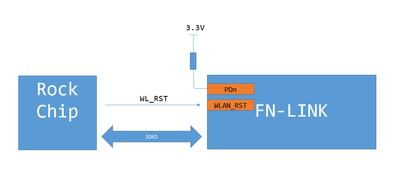

Hello NXP, we are now using 88W8987 for WLAN communication, for some reason , we didn't connect PDn pin to our controller, we just pulled it up to 3.3V through a 4.7K resistor, I am wondering if there is some software method to reset 88W8987, eg. is there any register that can be accessed by SDIO to issue a soft reset?

Hello @Alexis_A , We are using FN-LINK(88W8987),facing with our rockchip controller, our hardware diagram is as below
the problem is:
1. The SDIO communication goes well after power up , but after our SoC issue a reset using WL_RST, SoC got no response from SDIO when we issue CMD5(IO_SEND_OP_COND).
2. there is no reset pin in 88W8987, only a PDn pin. We found that WIFI function(connect and ping) goes well no matter the WL_RST is high or low. we doubt that maybe for FG6221 , the WLAN_RST is a NC pin.
3. We didn't connect PDn to our Soc , So I am looking for another way to reset the wifi module to see if we can solve problem 1.

Thank you @Alexis_A , Sorry , I made a mistake , the wifi module is FN-LINK L287B-SR, Not FG6221.
OS : RockChip PX30 SoC, Android 9, Linux 4.4.189
Driver : SD-WLAN-UART-BT-8987-U16-MMC-W16.87.10.p134-16.136.10.p134-C4X16687-GPL.zip
Errlog:sdio-timing-boot+kernel.xlsx(see attached file)
Column I indicates all no response CMD, you can also see the CMD is in UBOOT or Kernel via column H
This error occurs if we don't send a low voltage pulse on PDn before wifi module initialization in kernel.
