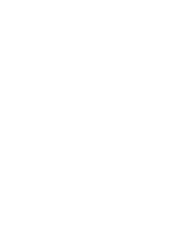

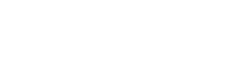

赵国海
DDR memory access error occurs only when the power-up or reset, once an error occurs, the error continues to occur. Once correct, access is always right (test 12 hours).
Probability of success is 70% on power-up or reset.
Error very regular,Error is very regular, the second byte is always 0xff. my test code is as follows.
Results is as follows
3,443 Views
赵国海
if I read it again in “printf”,the result is read correctly in second time. so I think DQS-read parameters unreasonable.
