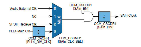

I tried to verify which clock exactly is slected by the SAI bus clock selection (TCR2[MSEL]=0).
Let's start from the obvious: When I set TCR2[MSEL] = 01, I get the clock defined CCM_CSCMR1[SAIn_CLK_SEL], more over the whole logic including the gate CCM_CSCDR1[SAIn_EN] and the divider CCM_CSCDR1[SAIn_DIV] works as documented in Chapter 9.10.12 SAI clocking.
However, when switching to TCR2[MSEL] = 00, unexpectetly the output clock does not change. Also, when I use the gate from above (CCM_CSCDR1[SAIn_EN]) my bit clock gets disabled too, hence it looks like the two MSEL are actually the same SAIn clocks, as configured in CSCMR1 and friends. Is this really the case or am I missing something? IMHO, the documentation is somewhat unclear if Bus Clock actually really selects the SAIn clock too...

Hi Jiri,
Sorry, maybe I was a bit unclear, but this does not really answer my question. I do get an output clock. my concern is the possible selection using TCR2[MSEL]
My question is: Which clock is used if TCR2[MSEL] is b00. According to the reference manual, chapter 3.11.1.2.3 "SAI transmitter and receiver options for MCLK selection", table Table 3-30, b00 is "Bus Clock". However, it looks like it is the same as when using b01, hence not bus clock, but clock selected by SAIn_CLK_SEL...

Sorry it took me a while to respond. I did not try to use CKO1 to access SAI0 clock, quite possible that this is working. The problem does not seem to be the CCM_CSCMR1[SAIn_CLK_SEL] selection, but within the SAI IP itself.
The clock selection I'm trying to  switch is SAIx_TCR2[MSEL]....
When using TCR2[MSEL] = 01, I expect the clock defined in CCM_CSCMR1 so it can be External clock, SPDIF clk or PLL4 Main clk. => This works fine!
When using TCR2[MSEL] = 00, I expect bus clock (IPS bus clock) as SAI input clock => This does not work. I get the same clock as when using 01 (like above)
So, what I'm saying is, that TCR2[MSEL] = 00 does not allow to select the IPS bus clock as documented...
