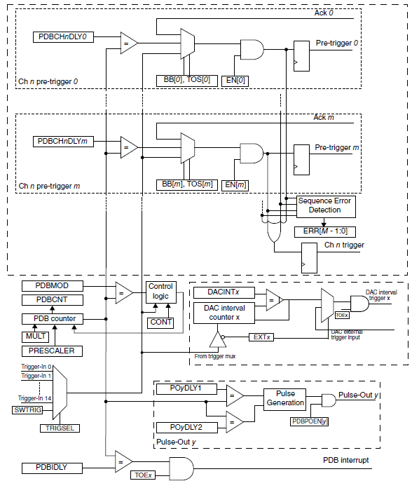

Currently working on implementing hardware gpio trigger support in Linux using the IIO subsystem for the Vybrid ADC driver. Have got a working implementation ready, but, there are few things which are currently not clear to me on reading the Vybrid TRM when it comes to using multiple channels and my trial and error approach has not cleared my understanding.
Trigger support for ADC requires configuration of the Programmable Delay Block peripheral. In the PDB block, there is a Channel n Control Register 1 in which there is the Pre Trigger output select and Pre trigger enable bit fields. There are two valid bit fields, however there configuration is currently not clear to me.
Is it possible to configure the PDB block for triggering and allow sampling of multiple channels? From the Page 1747 of the TRM which describes the register and the corresponding functional description on 1750, this would seem possible, however trying to configure the PDB currently gives me sequencing errors. The operations I currently perform are as follows
1. Set the bit 0 and 1 of the TOS and EN field of  CH0C1 register
2. Set ADC_HC0 to one channel from ADC0 and ADC_HC1 to another channel from ADC0. For my case this is channel 8 and 9 with the ADC0 block.
3. Set a delay with the CH0DLY0 and CH0DLY1 registers.
4. Finally set PDBEIE, PDBEN and LDOK
This immediately raised the PDB sequencing error interrupt handler which I have configured when the hardware trigger is given with the GPIO. So my configuration seems wrong. What is the correct way to configure the PDB for multiple channels? From what I understand atleast two simultaneous channel readings should be possible and from what I read on two other posts which I found in the community, it should be doable?
Can someone clarify the PDB configuration to me for the above use case?

The BB bit enables the back-to-back operation. if you refer to the below diagram:
You will notice that you have 3 possible options to enable the pre-trigger. When back to back is enabled the Ack signal that comes from the ADC_COCO triggers the pre-trigger signal. [BB = 1]. In this mode, when an ADC conversion is done, this trigger the other PDB channel which starts a new ADC conversion from other ADC module and channel.
Other mode is to bypass the channel. In this mode the signal selected by the TRIGSEL feeds the pre-trigger.
Or the pre-trigger may be fed by comparing the PDB counter with the PDBCHnDLYm.
Vybrid features 2 ADC modules ADC0 and ADC1. Each module has 2 set of control registers that you can use to sample 2 different channels, but not at the same time. This is because the ADC module has only 1 SAR unit.
All this means that with 2 ADC modules, you can only sample 2 ADC channels at the same time (one channel per ADC module).
But with the use of the second set of control registers and the PDB you can prepare the next conversion, so you will sample other 2 different channels when the first 2 are done.
Alejandro

At the end each ADC module can sample one channel at the time. If you have 2 ADCs you can sample just 2 channels at the same time (using ADC0 and ADC1).
As you know each PDB channel is associated with one ADC module.
According to your comments above you used CH1_DLY and CH0_DLY, it seems that you used one pre-trigger for each PDB channel. But please check that you have PDB_CHnDLY0 and PDB_CHnDLY1, this means that you can trigger an ADC module and use ADC0_HC0 first and then ADC0_HC1 with PDB_CH0DLY0 and PDB_CH0DLY1 respectively.

Yes, you have to make sure that the PDB counts are enough so the ADC conversion finishes.
Have you tried to change the external hardware trigger select when one conversion finishes?
So a different external hardware trigger is used:
From RM:
When the conversion is completed, the result is placed in the data registers associated
with the external hardware trigger received (active trigger selects ADC_Rn).
Alejandro

You are referring to the Note and paragraph at the end of section 37.8.4 I see. From what I understand, it implies that only particular external trigger should be used at a time. If this is what you are asking then yes, only one external trigger is used at a time for conversion. If I am using software trigger with continuous sampling, then trigger setting is not changed to hardware trigger while a particular conversion setting is in place for this.
In section 38.4.1, 6th paragraph goes like this
When a pre-trigger from a PDB channel n is asserted, the associated lock of the pre-trigger becomes active. The associated lock is released by the rising edge of the corresponding ADCnSC1[COCO]; the ADCnSC1[COCO] should be cleared after the conversion result is read, so that the next rising edge of ADCnSC1[COCO] can be generated to clear the lock later. The lock becomes inactive when:
• the rising edge of corresponding ADCnSC1[COCO] occurs,
• or the corresponding PDB pre-trigger is disabled,
• or the PDB is disabled
The channel n trigger output is suppressed when any of the locks of the pre-triggers in channel n is active. If a new pre-trigger m asserts when there is active lock in the PDB channel n, then a register flag bit CHnS[ERR[m]] (associated with the pre-trigger m) is set. If SC[PDBEIE] is set, then the sequence error interrupt is generated. A sequence error typically happens because the delay m is set too short and the pre-trigger m asserts
before the previously triggered ADC conversion finishes.
The last line above is quite understandable and expected. The lock thing is not clear however. I do not see ADCnSC1 registers either. The COCO bits are in ADCx_HS. Which lock and does ADCnSC1 refer to ADCx_HS? As such I clear ADCx_HS[COCOx] in the IRQ handler, so if Channel 0 was pretriggered and COCO0 was found to be set, after reading from ADC_R0 I clear ADCx_HS[COCO0].

alejandrolozan1
Sorry for the delay,
I just tried the below simple code and debugging with IAR I notice that both ADC_R0 and ARC_R1 are working with the PDB:
Please refer to it and let me know if that helps.
