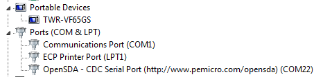

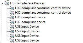

jiri-b36968
Hi Peter/Naoum,
P&E v1.08 equals to 004 mentioned before. If bootloader mode is active you will see:
If normal mode is active with default app (virtual serial port) you should see something like this:
where TWR-VF65GS is "disk" with Virtul serial chanel driver info
if CMSIS-DAP is loaded, then it behaves like USB Input device
/Jiri

adiroot
It turns out that CMSIS-DAP was actually running.  What threw me off what that
1) In SDA_INFO.HTM, it reports as being version 0.0
2) It is not easily found in device manager.  It appears as a HID-compliant device and an USB Input Device.
     * In Win7, you can easily see it under Control Panel > Devices and Printers as OpenSDA CMSIS-DAP.
3) P&E's utilities do not find it
