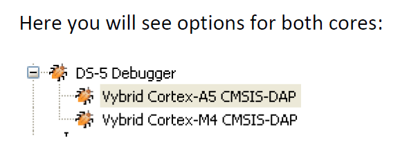

page 9 of the guide:
On my computer: I do not see these two options. Instead: this window appears:

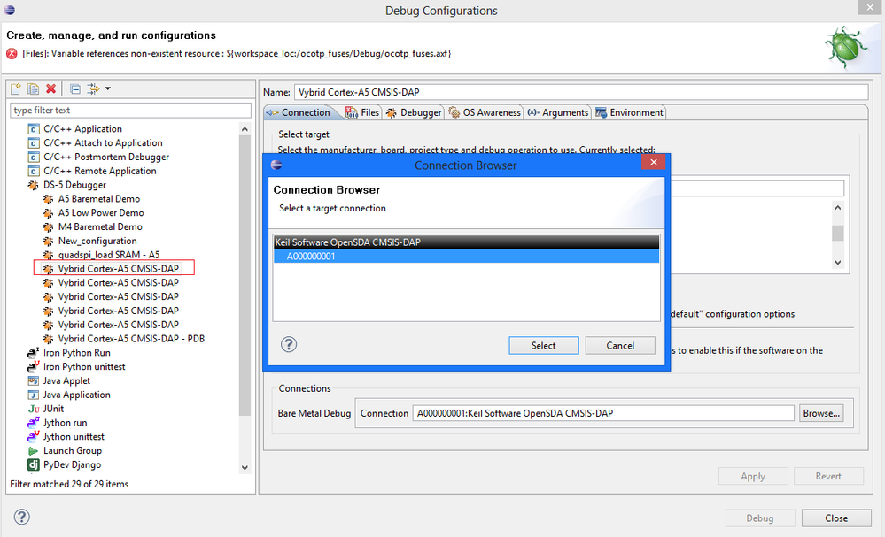

This is as far as I could go since I could not establish a connection with the board. The only connection detected was in the first Vybrid Cortex-A5 CMSIS-DAP:
However, when I selected this connection, the Debug button remained grey.

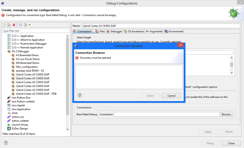

In all the other sections, there was no connection detected:

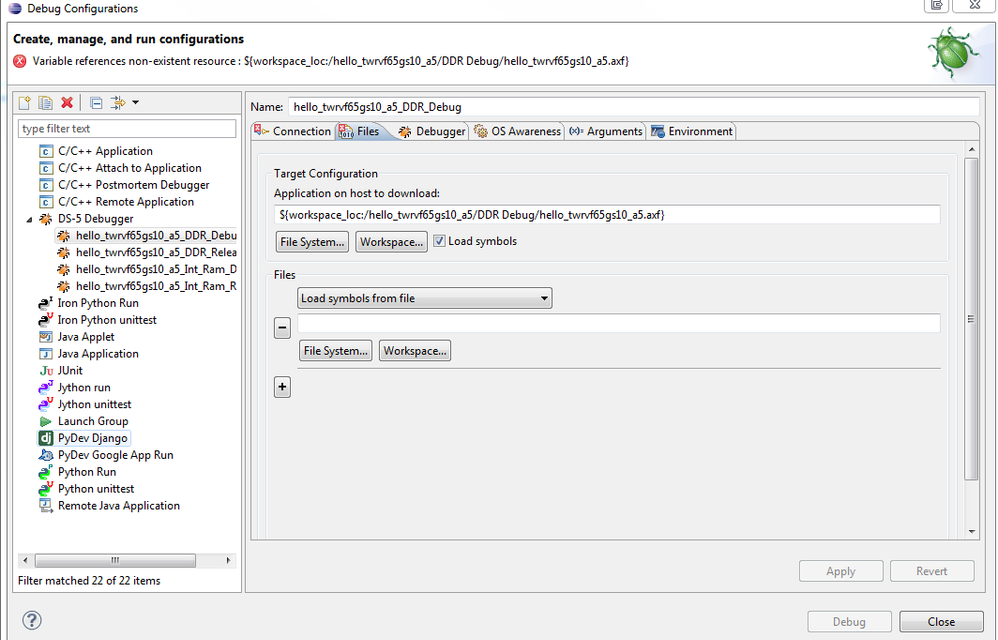

If you look at the "Files" tab, you can see that there is an "X" on it. This means there is something wrong therein....

Yes, on my setup there is something wrong because I have compiling errors.
But in your case, your images 6 and  7, the Files Tab have also "x"  that means either that the project has compiling errors or you are not choosing the correct .afx file generated by the correct target (DDR, SRAM, debug or release).

Ok thanks I think I found what the problem came from.

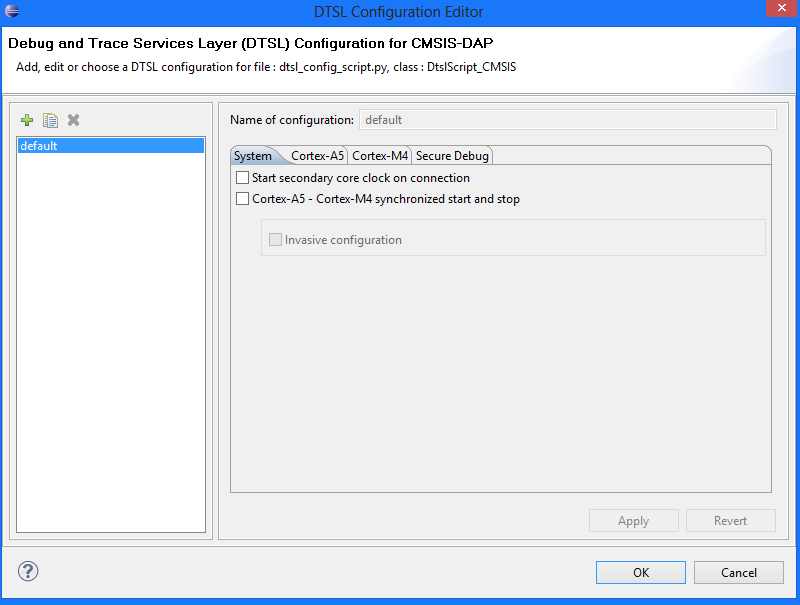

In the following of the guide however, they ask to check one of those two boxes:
Any idea why they do not appear in my version of Eclipse? Do you know where I can find them?
The version of Eclipse I am using came from a zip file named: DS500-BN-00022-r5p0-17rel1

On the Files tab you have to make sure that you are chosing the correct .afx file to load.
You can look for the file either in your workspace or the File System.
