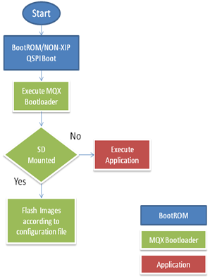

  1. The bootloader and applications are stored in QuadSPI memory.
  2. An application or bootloader upgrade can be performed, placing the new images in an SD card. The SD card is needed only to re-flash the QuadSPI memory.
  3. If and SD card is detected by the bootloader at startup and correct configurations and images are found, the bootloader will flash the images in QuadSPI. If it is not detected, the bootloader will execute the current image found in QuadSPI memory.

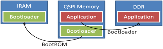

The next figures show an example of the implementation.
The BootROM code loads the MQX Bootloader from QuadSPI in iRAM.  When the MQX Bootloader starts, it checks if there is a mounted SD. If the SD contains valid application binary files and a valid configuration file it flash the images into the SD.
