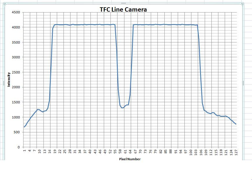

I have discovered a few issues with the camera and the latest FRDM-TFC (perhaps I have a bad one). [And yes, I did cover the back of the camera PCB since light bleeds through the PCB into the array (also mentioned in ProTip #1 Line Scan Camera Use)
1. The sample rate of the camera data is too slow (1 Hz or so). I estimated the 1 Hz by watching the led lights change and seeing labview updates.
2. My particular camera seems to be off by 20 degrees (I have to point it to the right by 20 degrees or so to get it to show up in the middle of the labview (see attachment). I wonder if this might be a poorly mounted array or perhaps misaligned lens? I will ask John if I can try another one.Capture.JPG.jpg
25,948 Views
jefff
Ok. Thx for the above replies. Turns out that my camera is fine. Thx to David for offering to scope the camera for me at lunch today. My issue must have been due to sampling issue using the ADC code etc... I was just jumping the gun and wanting to see the camera output now that I have my car all put together.
My son and I are having a blast with this !

danielhadad
Jeffrey,
You may want to adjust the focus on your camera as well.  The dips should look nice and square.
20,794 Views
jefff
Daniel,
Yeah, my focus was off. thx.
I had not looked at the code in detail as I had just assumed it was verified and checked in and matched the CW code. I got rid of the inner j loop and it works better,

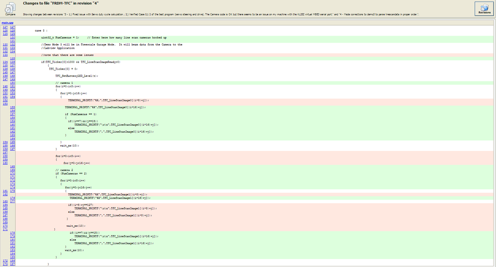

danielhadad
Wasn't a big deal-- just saw the "has issues..." comment and thought the bugs were intentional.  But having scope data to tell me something was wrong was key.  Will try to check in update in mbed soon.
20,794 Views
danielhadad
Update made in mbed-- up to 4.0 on the library now which has the fixes.
20,794 Views
jefff
Thx. Just curious. Do you have a summary of the changes you had to make?
20,794 Views
danielhadad
1) make # cameras an option so it doesn't run second set of loops if only 1 camera
2) fix '8' to '16' everywhere (i*16+j)
3) put in end of line stuff for first camera (if there is only 1 camera).
4) condition for end of line made to be ((i==7) && (j==15))
If you want code diffs- just check out library as separate thing in mbed and you can do version compare between 3 and 4 (file revisions...)
Here is the diff screenshot:

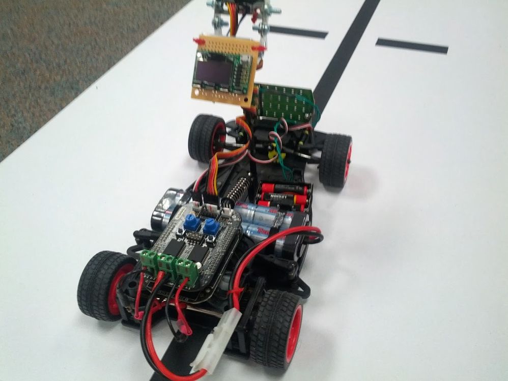

danielhadad
I can give you a tip: got a $3 flashlight from Harbor Freight that has over 24 leds in it with batteries! Hacked it apart and mounted it.
20,791 Views
jefff
Assuming you connected directly to battery, did you use current limiting registers or a LM317 regulator/(POT or PWM) for the mounted lights?
20,791 Views
danielhadad
I brought over the battery from the flashlight as well.  The lights have 'dark patches' so I plan to remove them from the PCB that came with the flashlight to mount them myself.
That said, supposedly a good line processing algo doesn't need good lighting :smileywink:
Here's a pic of my car showing the lights in front with separate battery pack.   Note the o-scope mounted on the camera mast to review camera data.

jefff
Very cool picture of your car!
I did not realize you brought the battery pack with it. I actually wired mine into the main regchargeable battery hence my question.
20,782 Views
