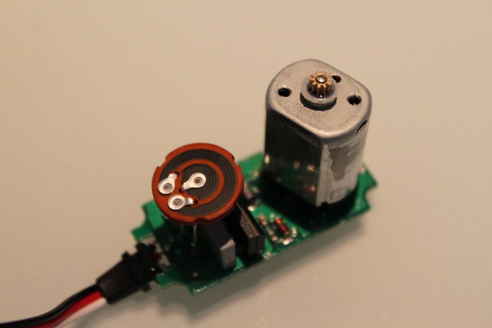

Servos are specialized dc motors geared to produced high-torques and set at specific angles vs rotating continously. The ability to position the servo at a specific angle over and over makes them ideal for robotics, radio controlled car and other various applications. A typical servo will have range of motion from 180-270 degrees. Most modern servos have a three wire interface, red (V+), black (ground), and white (control). To control a servo you must send it a variable length commands (pulse) in 20ms increments. This type of control is called Pulse Width Modulation.
