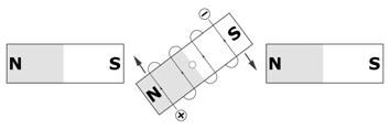

An electromagnet, which is a piece of iron wrapped with a wire coil that has voltage applied in its terminals. If two fixed magnets are added in both sides of this electromagnet, the repulsive and attractive forces will produce a torque.

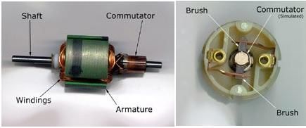

Then, there are two problems to solve: feeding the current to the rotating electromagnet without the wires getting twisted, and changing the direction of the current at the appropriate time. Both of these problems are solved using two devices: a split-ring commutator, and a pair of brushes.
As it can be seen, the commutator has two segments which are connected to each terminal of the electromagnet, besides the two arrows are the brushes which apply electric current to the rotary electromagnet. In real DC motors it can be found three slots instead of two and two brushes.

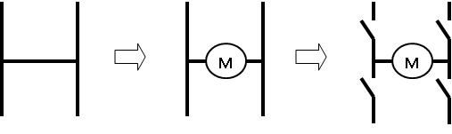

So there is not a third wire to control a DC motor, but knowing the previous behaviors it can be designed a way to control it, and the solution is an H-bridge.
Look at the last evolution of the DC Motor above, you can observe that there are four gates and a motor connected between them. This is the simplest H-bridge, where the four gates represent for transistors. By manipulating these gates and connecting the upper and lower terminals to a voltage supply, you can control the motor in all the behaviors as below.
