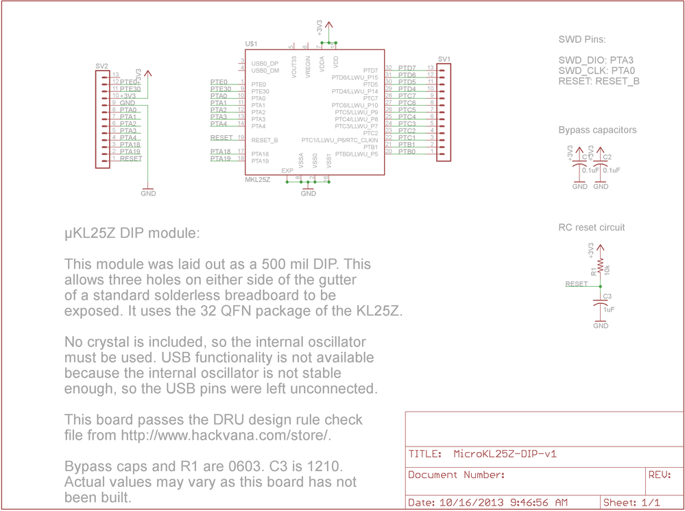

2 layer board of 0.65x1.35 inches (16.54x34.29 mm).  Minimal component requirements. You can buy the board from Osh Park ($4.95) or download the design files here!

It'll be better if it comes in completely soldered unit, on-board programming interface and pin compatibility with Arduino Nano. It can be named "Nano Freedom Board" :smileylaugh:
In order to put the on-board programming on, the K20 needs to be put somewhere. The McHck from http://mchck.org can be used as a small external programmer; that board can be ordered from OSHPark, too. Here is the schematic:
I still need to formally test this board; I am awaiting them to arrive.  I expect that it will work without incident like the 64QFP one I built.  The QFP is much easier to solder... [More info on the QFP board here.]
My intent with this board as well as the QFP one was to make KL25Z boards that I could employ for various functions. I am in need of more than a handful of boards and the FRDM-KL25Z, while very attractive, becomes cost prohibitive in the quantities I need. Once the software for each function is mature enough for service, the programmer is no longer necessary.  That'd be why there's no programmer on the board itself - I'm using the FRDM board.
The board has been tested and it works.  It's important to note that the code loaded needs to use the internal oscillator.
Order here: OSH Park ~ microKL25Z-v1
If using mbed, then here's a modified mbed library that uses the internal oscillator by default and which also operates it at 48MHz instead of the original FLL setting of 41MHz:
