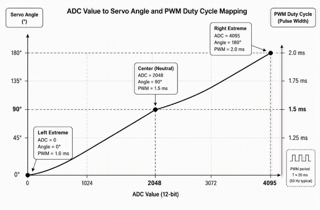

4.2 Signal Scaling — From ADC to Servo Angle
The ADC range (for example 0–4095) and the servo range (0°–180°, expressed as a PWM duty cycle) are different. The application performs a linear mapping so that one end of the potentiometer corresponds to one steering extreme and the other end to the opposite. This is the same scaling used in real EPS systems, where a hardware reading is converted into a normalized control command.
4.3 PWM — Pulse-Width Modulation and Servo Control
PWM switches a digital output on and off at a fixed frequency, varying the duty cycle (the fraction of time the signal is high). A hobby servo such as the SG 180° interprets this duty cycle as a position command. In this demo, the PWM is not generated by the MCU itself but by the Servo Click's dedicated PWM controller, which the MCU configures over I²C — a typical embedded pattern that offloads time-critical signal generation and keeps the CPU free for application logic.

7. Signal Behavior and Control Logic
Figure: Steering control signal mapping. The 12-bit ADC value (0–4095) is linearly mapped to a servo angle (0°–180°) and a matching PWM duty cycle (1.0–2.0 ms), with reference points at Left, Center and Right. At startup the servo moves to the neutral position; during operation, any input change produces an immediate, proportional reaction — implementing a basic steer-by-wire behavior.
