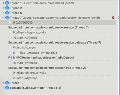

Octopussy
Hi ukcas,
unfortunately the call
var libraryManager : TLLibraryManager! = TLLibraryManager.shared()
will crash. Here is the crash log.
So there seems to be something wrong with the "TLLibraryManager.shared()" call.
If you want I can send you a bare bone project that shows the issue.
Thanks very much,
Martin

10,043 Views
ukcas
Dear Martin,
Since library is an obfuscated build, it is not possible to debug the executable. Therefore it needs to be disabled in IDE options.
Follow below steps.
  1. Select the scheme that you are using to run the application
  2. Edit Scheme
  3. In the Info Tab, uncheck the Debug executable option.
TapLinx team

Octopussy
now the app no longer crashes. Thanks for that hint.
I guess to save other people a lot of time this info should go into the "UG10045.pdf" document.
