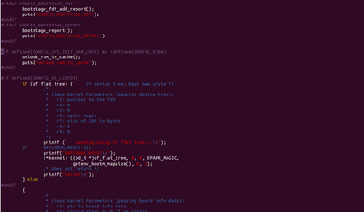

my boadr is t4240 Custom  board, I developed with sdk1.9, Now the kernel is stuck after uboot loads the device tree, Here is log:

## Transferring control to Linux (at address 00000000) ...
Booting using OF flat tree...
WATCHDOG_RESET
It's stuck at the kernel jump entry, Are there any bugs in t4240 startup that need to be fixed ?
I modified the bug according to the following, but my problem is still not solved
https://git.kernel.org/pub/scm/linux/kernel/git/torvalds/linux.git/commit/?id=5e95235
