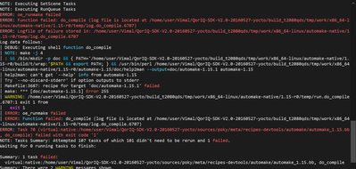

But I'm not getting the build configurations for the T2081QDS processor, I'm getting only the T2080QDS. I have started using the T2080QDS but still facing error while giving this command "bitbake -c compile -f u-boot". but I'm facing the error.

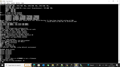

I have taken the u-boot from the YOCTO project and then build it for the T2081QDS processor.
I have flashed the images to the board.
In the booting I got the U-boot prints but, it stuck after the stopping the u-boot from auto-boot.
I cannot be able to enter any commands to proceed.
PFA,
2,382 Views
yipingwang
Are you using T2081QDS demo board or your custom board?
Please check whether the switch setting are correct.
It seems that you are bringing up new custom board. According to the u-boot log, there is problem at DDR controller initialization. Please use QCVS DDRv tool to do DDR configuration parameters optimization and validation.

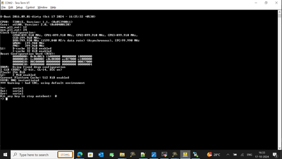

Vimalprasad
Hi @yipingwang ,
Please find the latest u-boot log for your reference.
here also the u-boot stuck after stopping the auto-boot, can't able to enter commands.
2,331 Views
Vimalprasad
Can you please verify the above u-boot log , whether the DDR configuration is proper or not?
