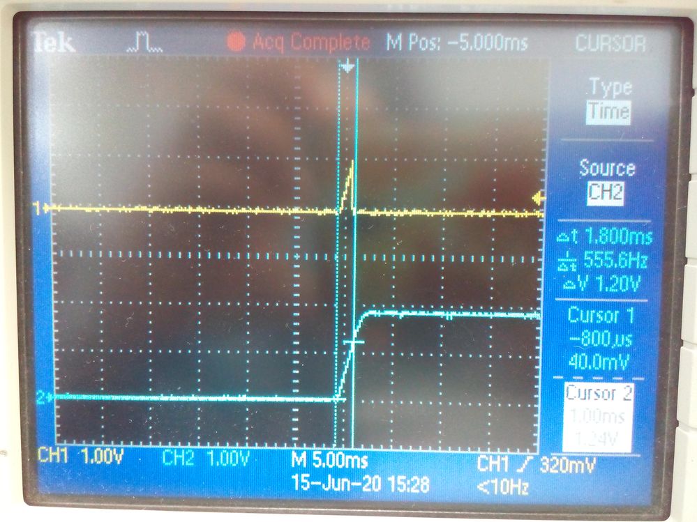

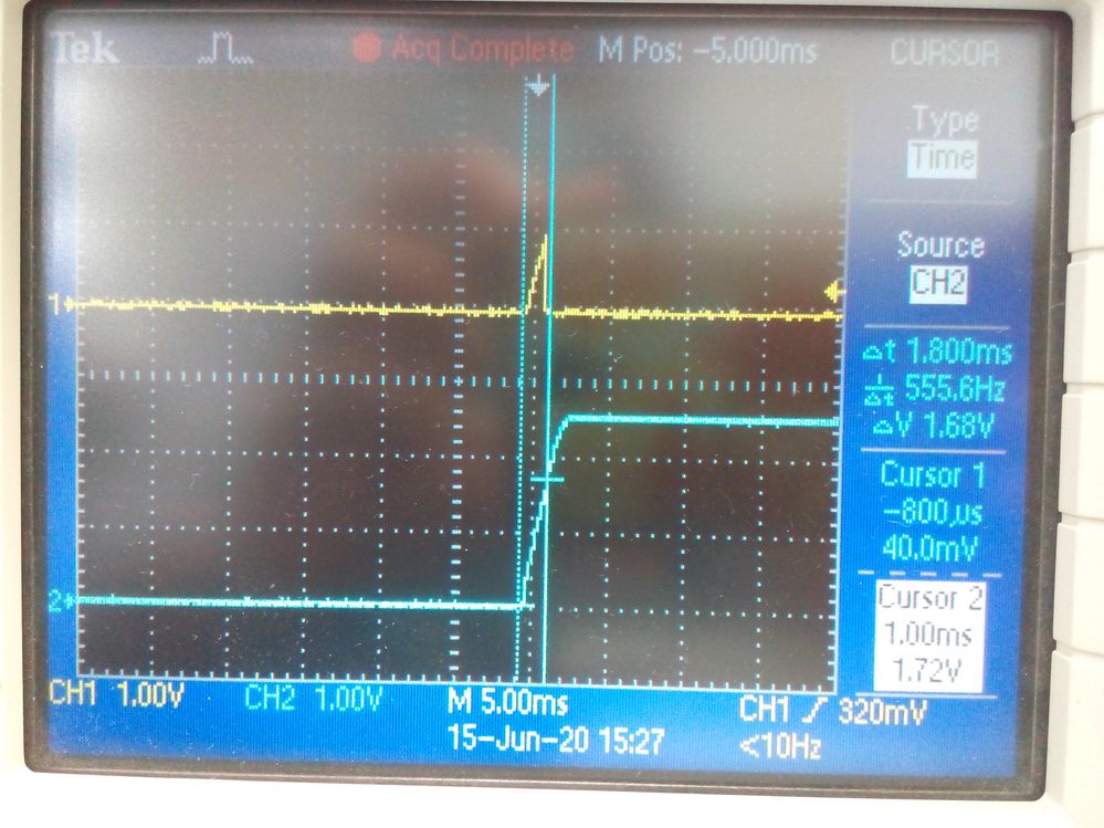

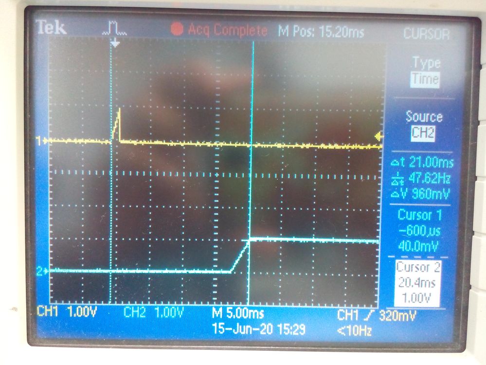

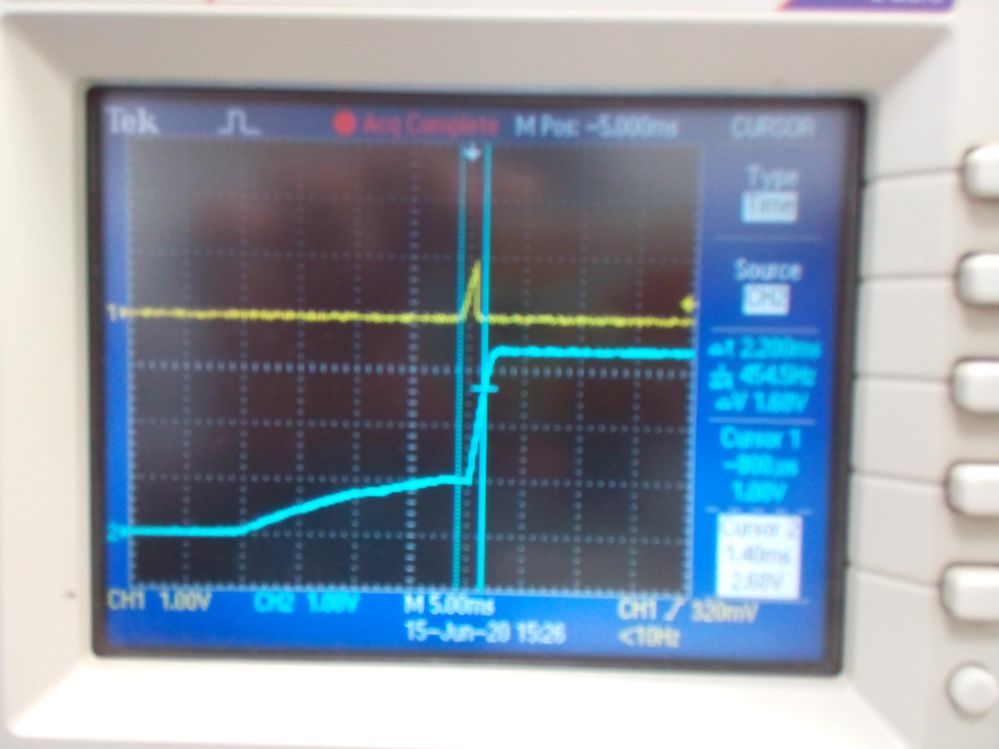

abhijit_pethkar
Hi Fedor,
I have captured the rise time waveform of some on the board voltages. Can you let me know if they are correct?
POReset_1V0_Voltage.jpgPOReset_1V8_Voltage.jpgPOReset_1V025_Voltage.jpgPOReset_1V35_Voltage.jpgPOReset_2V5_Voltage.jpgPOReset_3V3_Voltage.jpg
10,152 Views
ufedor
What are these voltages?
There are no notes.
To check ramp rate it is reasonable to use  1 ms time resolution.
10,152 Views
ufedor
