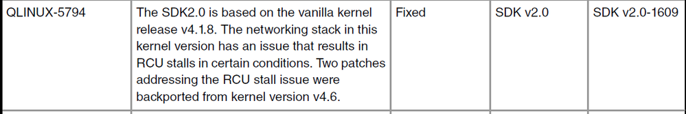

Did you use SDK 2.0 1703 release? I found this known issue in SDK 2.0 1703 document.
15,989 Views
jobs
How to modify bout  what"Two patches addressing the RCU stall issue were backported from kernel version v4.6". thanks

Thank you very much for your response.
I also tried nohz=off but nothing has changed, I got "the rce_sched self-detected stall on CPU{x}" message , and then the console is locked , but some cores are still alive and processing the packets.
We did the same tests by using T4240RDB board but there is no problem with T4240.
Maybe this is a problem of Linux operating system and in since there are more cores in T4240 than T2080 the problem is still exist but we could not succeed to create the problem in T4240. Maybe trying the latest linux kernels like 4.20 , 5.x will solve the problem.
The bad scenario for us is we are using T2080 in our custom board and we also get the same error. Finding the error cause by using T2080rdb is easier than finding in custom board, so we are using t2080rdb board in our tests.
