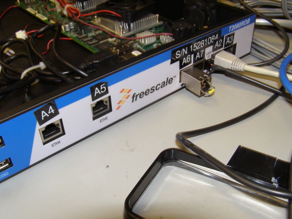

fm1-mac3 Link encap:Ethernet  HWaddr 00:04:9f:03:c9:8c
Connected to ETH4 on front panel
Label on this port on T2080RDB has last # of MAC as 8D (Port next to USB stack).
Is there a chance the board is simply mislabeled with the MAC stickers?

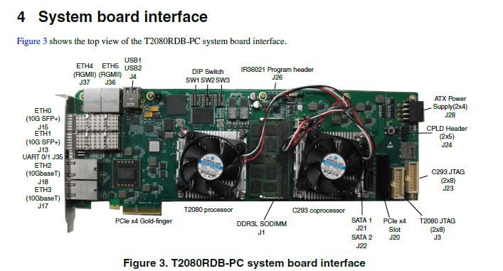

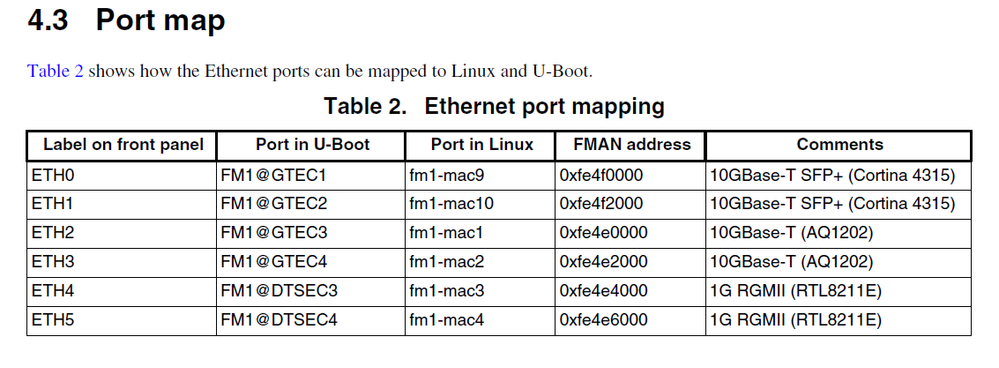

Is this table correct regarding assignment of front panel ports to u-boot/Linux?
I have two RDB's doing this same thing.
2,746 Views
ufedor
Please provide photo(s) of the stickers on your board.

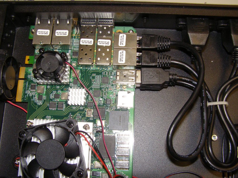

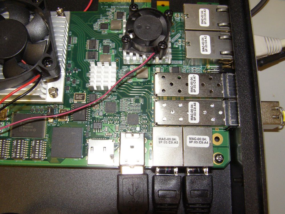

2,746 Views
elsasnow
From the QS guide, it appears ETH4 and ETH5 are swapped to front panel.
Here are our MAC labels (note routing to front panel.  Eth4 is going ot ETH5 front panel
A closer view:
Our front panel as assigned by actual MAC's
