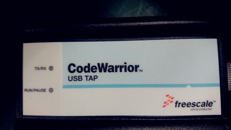

nickkung
Hi,all
Sorry for delay, I am busy with some other issues:smileyangry:, I was stuck in the 2nd step as I mentioned above, and I used the cw usb tap. Does it support t2080rdb debug?
4,482 Views
addiyi
Yes, CodeWarrior tap is supported for T2080.
Adrian
4,482 Views
ralftruebenbach
But this seems to be a CodeWarrior USB TAP and not a CodeWarrior TAP. Does the (old) CodeWarrior USB TAP also support the T2080?
