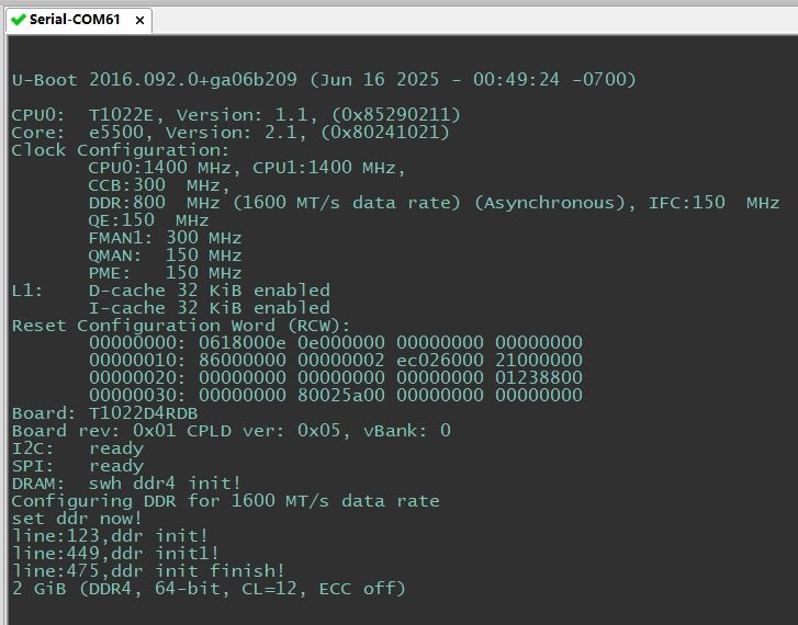

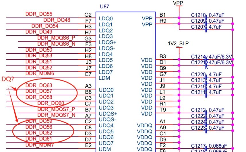

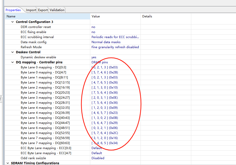

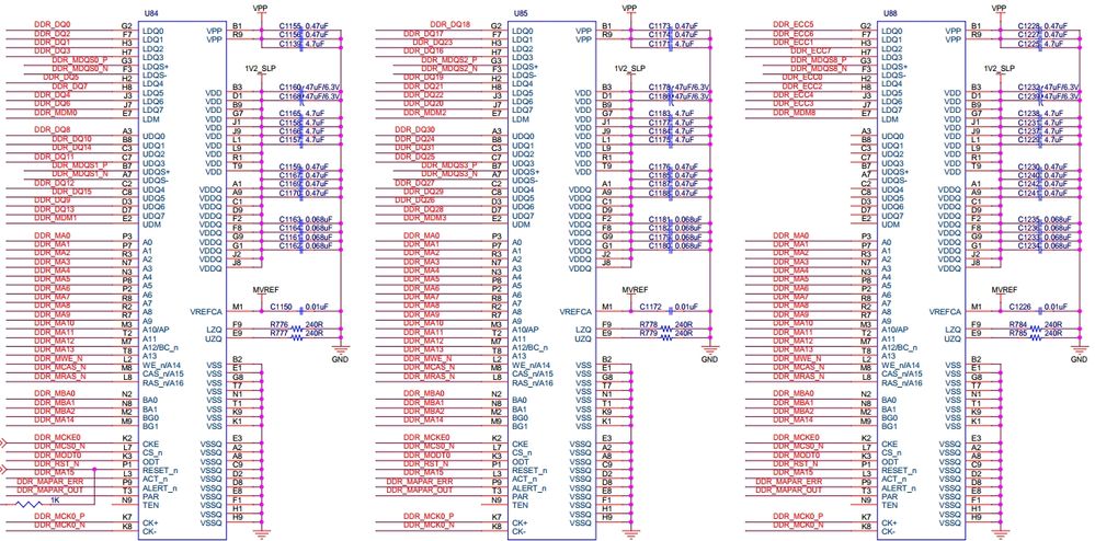

hello:
      We are having a customized board with T1022 processor,use DDR4 particles MT40A512M16LY-062E,now we want to ifc norflash boot,but now we can‘t boot.we modify uboot added macro definition CONFIG_SYS_FSL_DDR4 and freescale/t104xrdb/ddr.c, source code upload.we use codewarrior QCVS component generate ddr  arguments,then we modify ddr arguments,but now can not bootup,we do not modify DQ maping in QCVS,please help us to solve problem,thanks!
Spoiler

puts("swh ddr4 init!\r\n");
dram_size  = fixed_sdram();

we do not know how to modify QCVS DDR DQ maping,QCVS DDR other arguments use ddr4 datesheet

yipingwang
If DQ signals are swapped within nibbles, this should be properly set in the DDR_DQ_MAPx registers.
For details, please refer to section "14.4.49 DQ mapping register 0 (DDR_DDR_DQ_MAP0)" in "QorIQ T1040 Reference Manual".

JohnieSi

yipingwang
Please use the value addressed in "Table 14-7. Bitfield settings for each byte lane" in T1040RM.

JohnieSi
yes,my board ddr dqmap do not find argument section "14.4.49 DQ mapping register 0 (DDR_DDR_DQ_MAP0)".
please check my board schematic diagram,we dqmap not DQ signals0-3 or DQ signals4-7 swapped,we setup schematic diagram,please tell me how to solve
