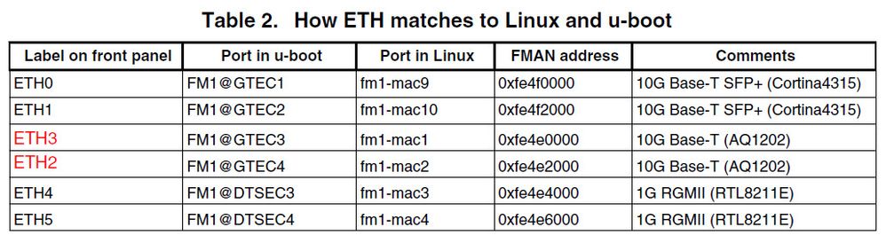

I am trying to set up a T2080RDB-PC. I can connect via console to access uboot/Linux. I have connected
the ETH2 port (as labelled on front of system) but cannot seen to get a network connection working from
either u-boot or Linux. Have verified that am trying to use the right port as the MAC address is printed on
the board socket, and have checked that this is what I am attempting to use from u-boot/Linux.
In u-boot have set environment so that FM1@TGEC3 is the default ethernet device, as sen from this u-boot
startup snippet:
Net: Fman1: Uploading microcode version 106.4.18
FM1@DTSEC3, FM1@DTSEC4, FM1@TGEC1, FM1@TGEC2, FM1@TGEC3 [PRIME], FM1@TGEC4
According to the user guide FM1@TGEC3 actually maps to the ETH2 labelled port, further confirmed with
the uboot bdinfo command that shows I am using the correct device:
ethaddr = 00:04:9F:05:34:46
When trying to ping from uboot, I get:
ping 10.1.0.22
FM1@TGEC3 Waiting for PHY auto negotiation to complete................................ TIMEOUT !
FM1@TGEC3: No link.
The ETH2 Tx/Rx lights on the panel are in a continuous alternating flash pattern.
Anyone any idea what is wrong?
Cheers Steve.

There is a typo in the QorIQ T2080 Reference Design Board Quick Start, Table 2.
Corrected version is:

Think is also general typo in that docs have "FM1@GTECn" whereas u-boot has "FM1@TGECn" :
In any case have tried both ETH2 and ETH2 connected directly to my PC and to a network switch. In neither case can not get device to work either from Linux or u-boot. From linux:
Are ports on PC and switch 10G?
2,873 Views
steveosselton
Both the ports are 1GB.
2,873 Views
ufedor
It is required to connect T2080 10G port to another 10G port or 1G to 1G.
