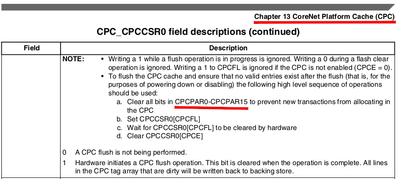

Hi Everyone,
As part of the platform cache flushing procedure, the T1042 RM states that "Clear all bits in CPCPAR0-CPCPAR15 " but we couldn;t find the base address of CPCPAR in the reference manual.
it looks like it was removed :
I know (using the Trace32) that the base address for CPC_PAR0 is CROSSBAR_ADR+0x10208, but we need to confirm this with NXP to document it as a rational.
thank you

Your understanding is correct.
CPC_CPCPAR0 address is equal to:
base address (specified by the CCSRBAR) + 0x1_0000 (CPC block offset address) + 0x208
