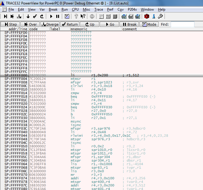

In trace32 when we reset the board the debugger will give control at 0xFFFFFFFC (Reset vector)... from there we can execute instruction by instruction and we can see the surrounding opcodes....
how can we do the same in Code Warrior Debugger...

Below are the screen shots from Trace32.. I didn't use any ELF file mappings still when I reset the board It's showing opcodes and assembly code..(I just connected the debugger and did target reset) I need similar functionality in codewarrior...How to do that?
Veerendranath

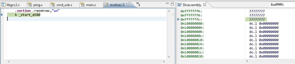

veerendranathj
After setting PIC.... source file is mapped correctly but in disassembly section I couldn't see any opcode/corresponding assebly code...

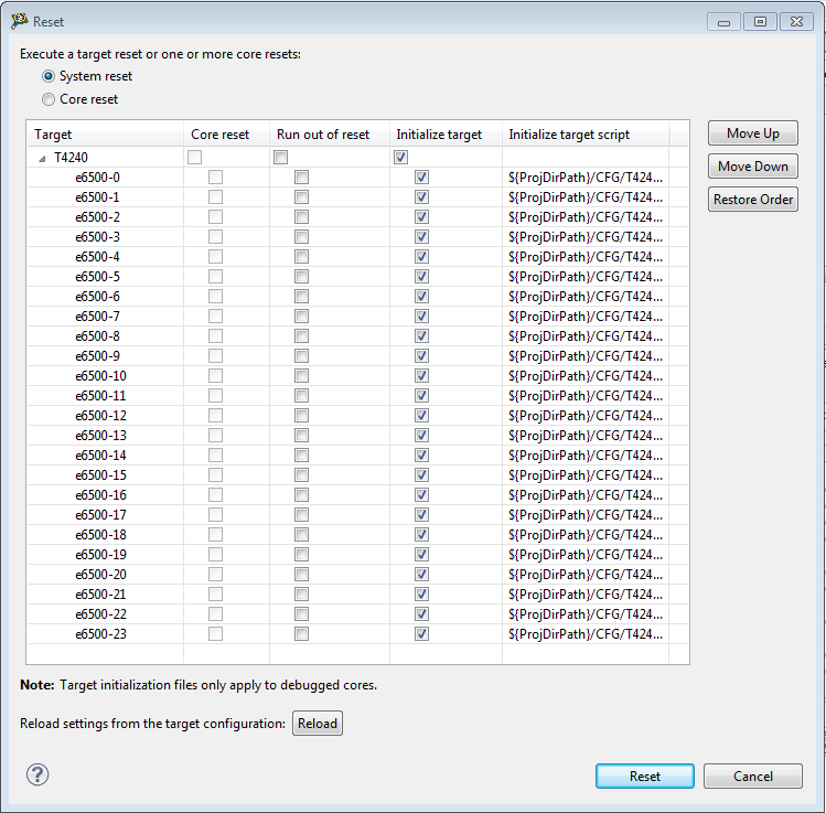

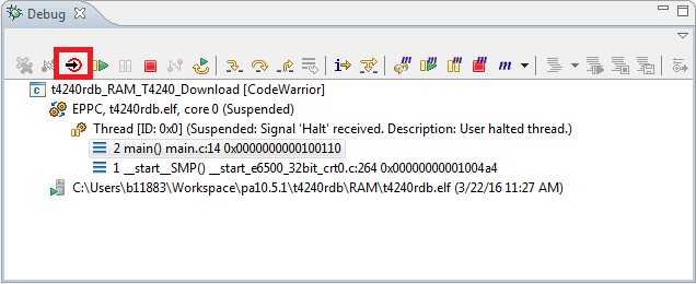

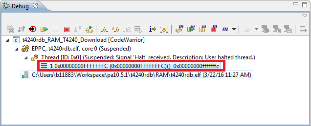

You can do all steps using CodeWarrior. After you connect to the board you can use reset botton, to reset the board with or without initialization file (depending on your scenario), After reset debugger will stop at reset vector.
Connection to the board and click on Reset:
Reset options:
Aftre Reset, Debugger will stop the core at reset vector:
Adrian
