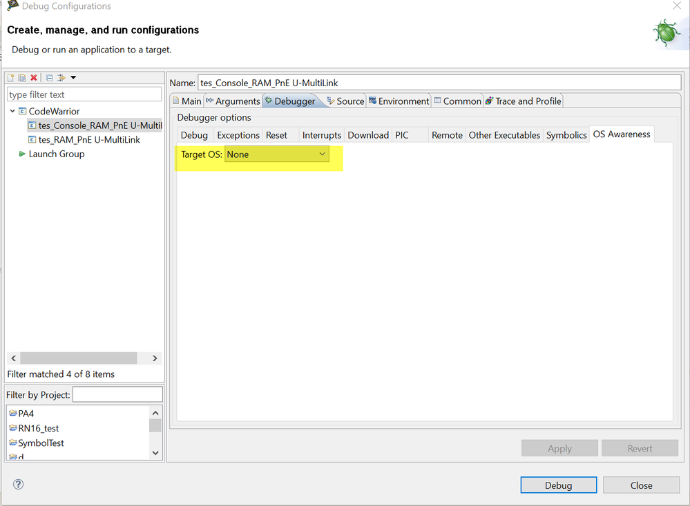

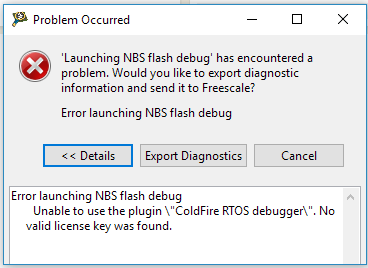

Just activated my CW 11.0, node locked perpetual license. Compiler is working but I get this message when launching the debugger. Project includes MQX but I don't plan on debugging it, just want to debug my code.CW error.png
1,330 Views
ZhangJennie
Hi Phill,
Please disable OS Awareness by setting Target OS as "None"
