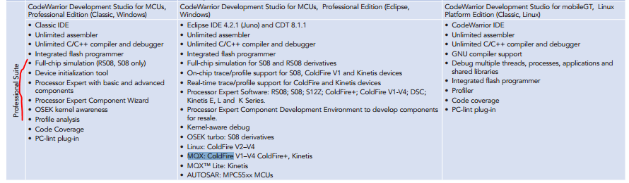

I suspect your BASIC Edition license does not include Kernel Aware Debugging MQX for ColdFire v2.
Please check the Quick Reference Guide below (search for "MQX: ColdFire")
This feature is supported in Professional Edition only.
http://www.nxp.com/assets/documents/data/en/fact-sheets/950-00437.pdf

First the license (license.dat) is not generated by USB Dongle License but it is generated on NXP licensing web and it could be locked to a hardware key - USB dongle FlexID. The unique locking number FlexID is printed on dongle body.
The license includes strings that identifies which version it is:
e.g. the license you attached contains lines below. It's clear that it is BASIC Edition and it's locked to USB Dongle with FlexID: 9-5e161548 (this must match with the FlexID on your dongle)
INCREMENT BasicEditionMCU metrowks 10.5 permanent uncounted \
                44FF0162E6A2 VENDOR_STRING="CodeWarrior for MCU Basic Edition \
                (Windows - Eclipse)" HOSTID=FLEXID=9-5e161548 \
                ISSUER="Freescale Semiconductor" ISSUED=15-jan-2017 ck=105 \
                SN="FSL - 18591747" TS_OK
It works fine with the temporary/evaluation license because this license is basically time limited Professional Edition.
Hope it makes more sense now.

MQX: ColdFire for MCF52259, Profession edtion codewarrior is only correct version. Could you please help to give  suggestion to solve it? which version of usb dongle should buy? Thanks.
5,569 Views
TomasPaez
You can upgrade your basic suite to professional by getting a BASIC 2 PRO  ID.
If you own a perpetual basic suite, you can use CWP-BAS2PRO-NL , or if you own an annual suite you can use CWA-BAS2PRO-NL
