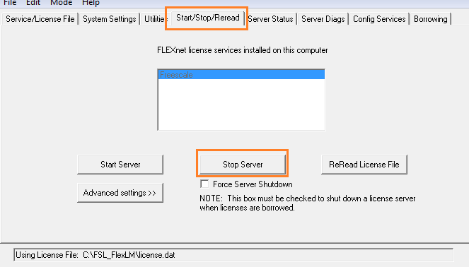

For the log file...
The log file gives us interesting info to understand the issue.
To generate this file, on the server launch lmtools, select Config Services tab.
Inside "Path to the debug log file" field define a file as:
  C:\FLEXlm\test.log
If it's already the case please:
  - stop the service,
  - delete the log file via explorer,
  - re-start the service,
  - reproduce the problem on client.
Provide us the file.
Pascal

My suggestion is to go to Sever side an open LMTool utility to re start the service on the server.
Make sure you have the same copy of the license file on the server side, even if you have a correct license on the client side , License will be read on the server side, and if this part is not there, this may be causing this error.
Regards.
