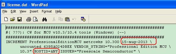

ZhangJennie
you can open the license.dat with nodepad.
for evaluation license. it records the expire date. and HOSTID=ANY
for example, below is the part of evaluation license. it's expire time is 15-aug-2013

Hi Jun,
That was the first thing I thought to do, but I can't find license.dat under my c:\freescale folder.
It's a cw10.3, doues it work differently now?

Hi Marina,
the file is inside the MCU folder, e.g.
C:\Freescale\CW MCU v10.3\MCU\license.dat
Note that if you do not have that file at all, the tools are running in 'special' (or free) edition.
