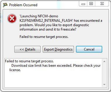

I've successfully applied the floating licence to CodeWarrior IDE on my PC on Thursday last week.  But since today afternoon, the debug feature doesn't seem to work properly (although compilation still works ), the error is as follows:

Could you advise what you I do to bring back debug feature? I kind of need this working urgently. I have been working on two temp licenses for two month. I very appreciate any help.
For the time being, can I request another temp license please?

I don't see real problem in the license file or in the log file.
Strange is that I don't see the issue in log associated to the error message: download size limit has been exceeded.
Now 2 questions.
      do you have C++ code or do you use the C++ compiler option ?
This could be the cause of the problem

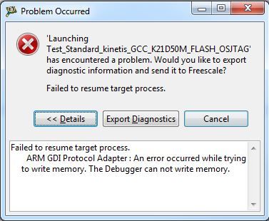

I am not using C++. There are no cpp files.
I have check through Project Properties > C/C++ Build > Tool Settings > ARM Compiler and see no C++ compiler option.
Could it be that I miss a setting?
Many thanks

Hi Kevin,
I'm remember a similar problem ... but in this case, the wrong license file was used.
According to the log file, it seems the floating license is working fine.
Is it linked to the project ?
    without the project it's difficult.
Is it linked to the license file ?
    Try with the temp license file attached.
Is it working ?
Pascal

The temp license file is working fine. I can debug from J-Link.
How do I check if the floating license is linked to the project?
Clearly there are some Professional edition feature that prevent me from running debug.
Kevin
11,379 Views
trytohelp
Kevin,
The previous file was Professional one.

Now back to sorting this license problem for good.
I managed to modify the code and build the project for the K21FN1M0A but had some problem downloading the code.
After I click debug, I have this error below
After this, I cannot talk to the K21 via the J-Link at all. I've used Erase command from Code Warrior with no success, and J-Link commander refused to establish a connection with the chip. I think I've written to a memory location that would trigger a JTAG lock-down or something.
Anyway, I don't think this error is related to the License error mentioned in previous reply. I generated firmware file is 512kB and I can download it to the chip using debug facility. The license I'm using is the Floating License for Standard Edition.
Would it be beneficial to uninstall then reinstall the Code Warrior Standard Edition?
Best wishes,
Kevin

kevinledinh
Hi Pascal,
Using the Standard Ed. license, I got the same error described in the first post:
Failed to resume target process.
Download size limit has been exceeded. Please check your license.
