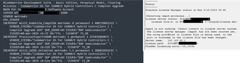

I am having trouble with setting up Code Warrior floating license server:
I have attached the flexlm server status error message and an extract of license.dat file.
The port and hostname in the license and flexlm are coherent so i don't understand why I am getting this error.
Can anyone help please?

Hi Jean-Fabrice,
Can you please open a CMD page and navegate to the folder flexlm and run the command lmgrd -z and send me a screen capture.
Also can you make sure that the portes are open on the client side and that the service has been enbled.
I have added adocument that will guide you on the process of seting up the License Manager.
