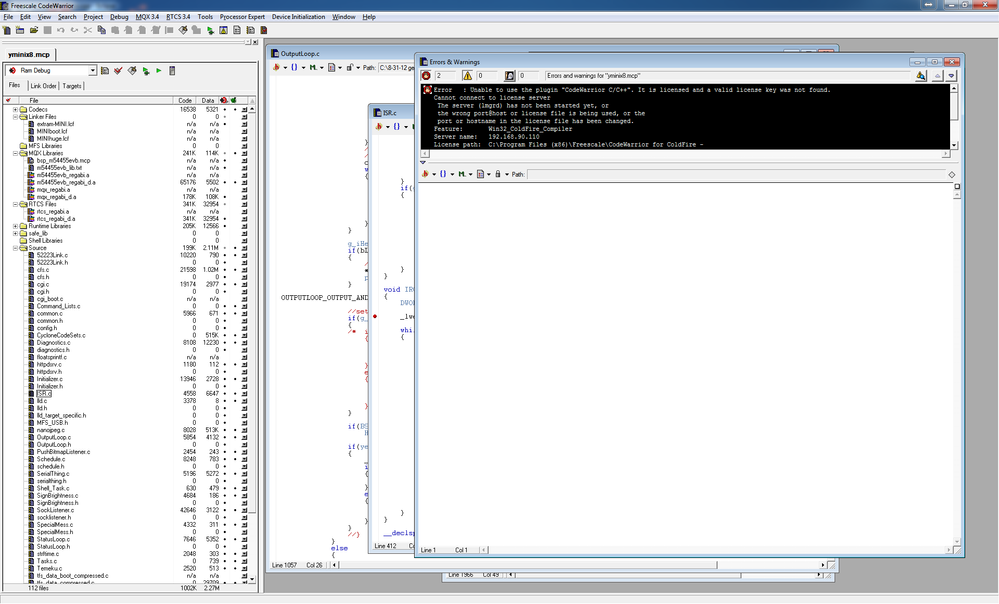

I have a floating license for cw7.  Until recently I had the license server running on the same machine that cw7 is on.  I moved the license server over to a different machine on the same network but now half the time when I try to open cw7 or start a debug session it says it can't contact the license server.  I'm thinking the license server is taking a little too long to respond?  Is there a way to specifiy a timeout?  That same computer is serving up a license for cw10 which seem to work fine.
thanks

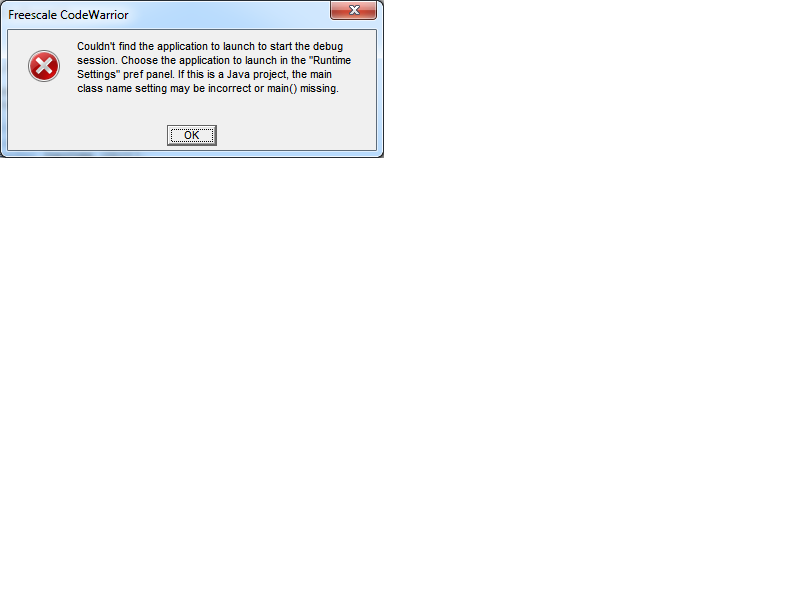

In some case (50%) you get an error when V7.2 is used.
The first error:
      "Couldn't find the application to launch to start the debug session"
I found 3 entries with this issue in our data base.
I don't find interesting info on them.
This error was associated to a license issue too.
According to the info you get the error:
     Cannot connect to license server.
      The server (lmgrd) has not been started yet, or the
      wrong port@host or license file is being used, or the
      TCP/IP port or host name in the license file has been changed.
I don't think the problem is linked to a timeout.
It seems in some case the client can not establish right connection to the server.
how are you using the license on client side ?
do you use the LM_LICENSE_FILE env variable?
Please can you provide us the floating license file used ?
If you want we can switch to a Service Request.

13:18:25 (metrowks) OUT: "Win32_ColdFire_Professional" cjohnson@optimusprime
13:18:30 (metrowks) IN: "Win32_ColdFire_Professional" cjohnson@optimusprime
13:18:30 (metrowks) IN: "Win32_ColdFire_Compiler" cjohnson@optimusprime
Here's some pics of the errors that pop up:

The first error:
