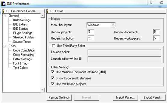

Attached you will find the project example I used.
If you can not open it please check if the "Use Test-Based projects" is selected.

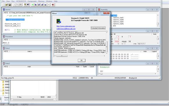

Please can you:
    - launch the debugger,
    - click on Help + About,
    - capture all information listed on the dialog message (scroll down).

The info provided is not from the debugger but from the IDE which is not relevant for this license issue.

attachment is from the help section in debugger... below info is what I saved from the information in this dialog box. also, I don't see the attachment. please send again, thank.
Directory: D:\work related\FAW\FAW Programs\FAW_AUTOMATICEnvironment file: D:\work related\FAW\FAW Programs\FAW_AUTOMATIC\P&E_Multilink_USB.iniGENPATH=D:\work related\FAW\FAW Programs\FAW_AUTOMATIC\Sources;C:\Program Files (x86)\Freescale\CWS12v5.2\lib\hc12c\src;C:\Program Files (x86)\Freescale\CWS12v5.2\lib\hc12c\include;C:\Program Files (x86)\Freescale\CWS12v5.2\lib\hc12c\lib;C:\Program Files (x86)\Freescale\CWS12v5.2\lib\xgatec\src;C:\Program Files (x86)\Freescale\CWS12v5.2\lib\xgatec\include;C:\Program Files (x86)\Freescale\CWS12v5.2\lib\xgatec\libLIBPATH=C:\Program Files (x86)\Freescale\CWS12v5.2\lib\hc12c\include;C:\Program Files (x86)\Freescale\CWS12v5.2\lib\xgatec\includeOBJPATH=D:\work related\FAW\FAW Programs\FAW_AUTOMATIC\binABSPATH=D:\work related\FAW\FAW Programs\FAW_AUTOMATIC\binTEXTPATH=D:\work related\FAW\FAW Programs\FAW_AUTOMATIC\bin
Web: <http://www.codewarrior.com>LM_LICENSE_FILE=License File: C:\Program Files (x86)\Freescale\CWS12v5.2\license.datApplication FLEXlm License Version: 2.000, 8.4aVendor daemon: metrowksETHERNET="9c4e36c947ed 9c4e36c947ed 9c4e36c947ec 3c970eb64707 005056c00001 005056c00008"HOSTNAME=Carl-PCDISK_SERIAL_NUM=44c41344HI407284 (metrowks, 5.000): HC12 ANSI-C Debug (HC12, checkout failed, demo mode: 1024 bytes of code, running in demo mode(-88), UNREGISTERED)System clock has been set backFeature: HI407284License path: C:\Program Files (x86)\Freescale\CWS12v5.2\license.datFLEXlm error: -88,309For further information, refer to the FLEXlm End User Manual,available at "www.macrovision.com".HI407285 (metrowks, 5.000): HC12 C++ Debug (HC12, checkout failed, demo mode: 1024 bytes of code, running in demo mode(-88), UNREGISTERED)System clock has been set backFeature: HI407285License path: C:\Program Files (x86)\Freescale\CWS12v5.2\license.datFLEXlm error: -88,309For further information, refer to the FLEXlm End User Manual,available at "www.macrovision.com".

Hi Carl,
Flexlm generates the error: System clock has been set back.
The tool detected you modify the PC clock to an older date.
When PC clock is set back, the tool detects it and doesn't allow anymore to use evaluation or any time limited license file.
To unlock it you need a permanent license file.
Un-installing / Re-installing the tool doesn't solve the problem (info is in registry).
To solve the problem there are 2 solutions:
    - purchase a permanent suite,
    - re-install PC (Windows OS).
