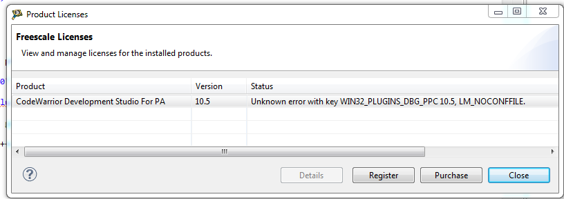

veerendranath
How to resolve below error...
When registered the product and generated "license.dat" file... now where to place the file to resolve the error?
Thanks and Regards,
Veerendranath

I think it's the first time I see this type of error.
Difficult to determine the cause of the problem.
The key question is:
      The tool is it working or not ?
In same case the Status dialog could be display a wrong message info.
Refer to the How to install/check if my floating license file is running ? (known issues)
    Specific trouble for CW for PA V10.4 & CW for MCU V10.6
If you've problem with the license file I recommend to report it to the Case system.
Please provide us more information as type of license file used (NL or Floating).

trytohelp
I got this error too in my side when no license file was present.
So it seems this error code inform us you don't have license.dat under \CW_PA_v10.5.0\PA

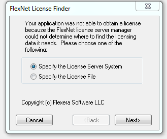

veerendranath
I am using floating type license.... I have placed the file under \CW_PA_v10.5.0\PA... Now It's showing below window... It's keep on asking for the license even after selecting licence.dat file... If I cancel the window previous error( i.e. error mentioned in the question) is coming...

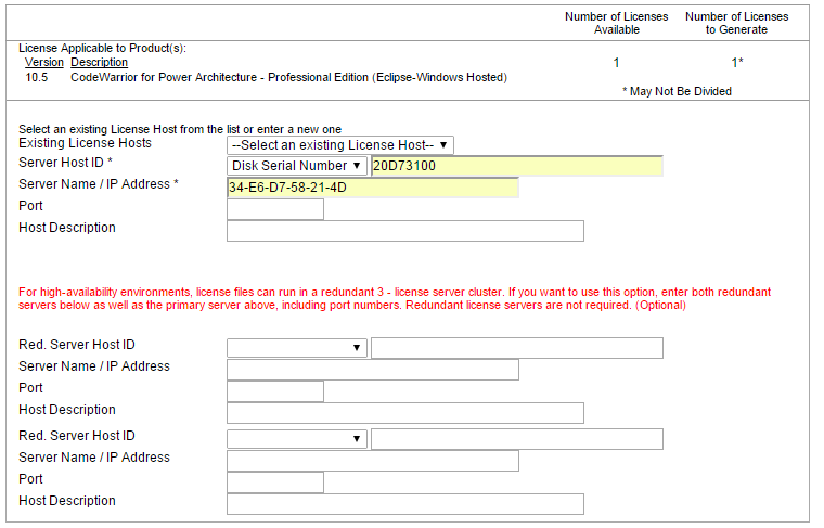

veerendranath
What should be value in server name/IP address? (and format of the value.. i.e whether dashes should be there or not?) while generating licence in below form...
Here I gave "My Ethernet interface MAC addres" as mentioned in quick start guide...
In my PC Wifi interface is also there and I will use wifi to connect network.. so should I use Wifi MAC address?

trytohelp
Please have a look to the community post:
To answer your questions:
    The server name or IP address (server) is given by the lmgrd flexlm tool you need to install on server
Please have a look to the doc:
    http://cache.nxp.com/files/soft_dev_tools/doc/brochure/FLTLICINSTWINBR.pdf
Refer page 11.
