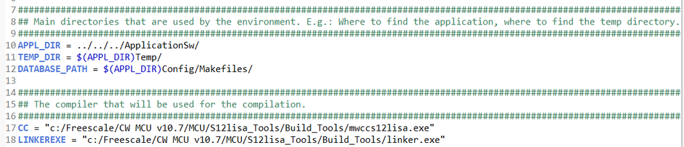

I currently have a paid license of the S12lisa toolchain but when I try to build our software, I get the following error:
"ERROR L4025: This limited version allows only 65536 bytes of C code"
When I open CodeWarrior and go to the Product Licenses window I can see that the license is activated (picture 1)
I also know that my makefile is linking to the correct license's path (picture 2)
In fact, the same project which I'm trying to build is being built by a colleague who also has the same license. I've been trying a few things to solve this but none worked so far. Any help on this issue will be very appreciated!

Hello  Denis,
This is indeed weird issue.
Could you please click on "Details" button and post the content here?
Can you attach also screenshot of  ERROR L4025 you get.

Issue solved. There was one environment variable missing.
