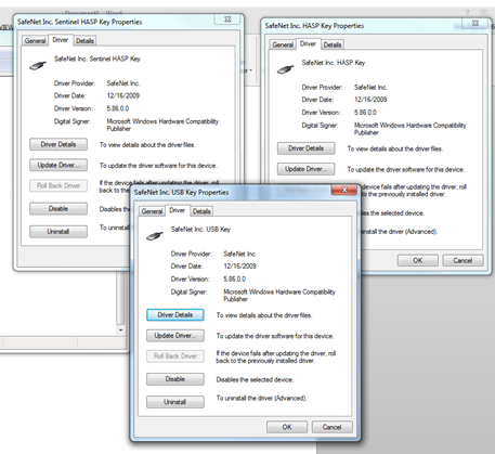

This doc will answer the question:
            Can we use USBdongle license under Win 8.1 ?
There are 2 parts:
  • - How to install the Dongle driver and check it ?
  • - How to use a development tool with USBdongle license file under Win8.1 ?
Attached you will find 2 videos explaining the processes.
Refer to the USBDongle_driver_installation.avi
     BEFORE Phase 4, to avoid problem we recommend to un-plug ethernet cable or switch-off wifi.
     If network connection is not switched-off, for Phase 4 and Phase 5, a wrong driver could be installed.
              Right Driver version (USBDongle + FlexID Driver installed + Windows 7 64bit)
To test it I used:
     -  CW for MPC55XX V2.7
          Refer to the USBDongle_win8_MPC55XX.avi
                              - CW for HC12 V5.1
                                   Refer to the USBDongle_win8_hc12v5.1.avi
                                    Include example project -> HC12_V5_1_test_project.zip
Hope this will help.
Pascal
